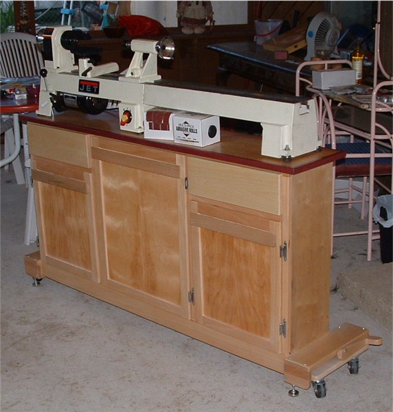

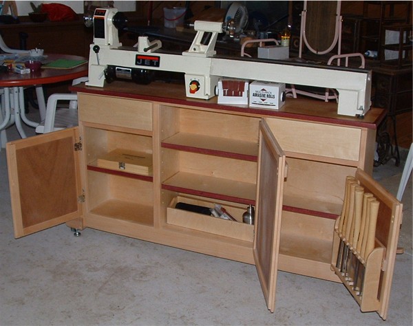

    I built this for my wife's lathe. Ballast wasn't used since she only does small items. The knife rack is on French cleats and can be hung on on the outside of either end door.

    Unfortunately she can't stand for long periods and I have to redsign a stand to allow her to sit on a stool with her legs under the lathe.
      I sure like Pappy's but this works for me.

        Thanks Don and Dick. I like the cabinet idea. But was concerned about it being stationary or mobile. I am thinking I would like a deeper cabinet. Don, how deep did you make your wife's? Phil

            The top is only about a foot wide so the inside of the cabinet is probably around 9".

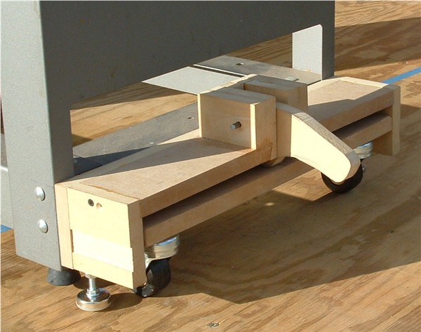

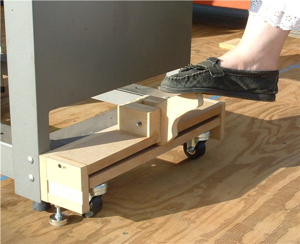

            The caster lift is from a Wood magazine mobile tool base. I wasn't happy with the lift lever design. The bolt works loose making the lever action sloppy, sometimes to the point of being ineffective. Also the action seemed a bit akward to me.
            I came up with a design for a lever that you pushed down. Even with her back problems, my wife was able to lift the Bt3 with no problems. This was the prototype made of MDF.

            I used the same design on my 8" Rockwell jointer base. Because of the weight, I have to lift the end of the tables a little as I step down.

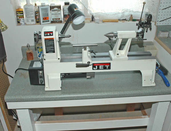

              My take on the subject is here.

                  Don, Putting a foot operated cam lever is a nice move. Sketches or drawings ? I have thought about adding something like this caster system to my BT3. Ray, Thanks for your link and thoughts. So how much does your setup weigh? Phil

                    All up, loaded with sand and tools as shown, I'd guess around 350lbs.

                        +1 on the request for a little more detail on the mobile base. are the other 2 wheels non-swivelling? that is a really elegant design.

                          Sorry, no drawings. The mod was designed on the fly. I do have some extra cams cut. I will trace them onto some grid paper and scan them in to post.
                          The original design from Wood called for 2 swivel and 2 fixed. I followed the plans on my bandsaw but found it hard to manuever. Everything else has 4 swivels with lifts on both ends.
