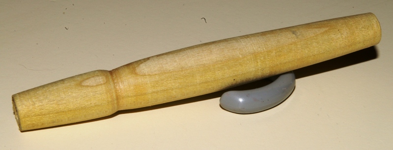

        Here's where I am so far..
        What I did was turn a block of poplar down to 5/8 so it would fit into my largest collet.
        stuffed it into the collet and drilled through the center.
        Then I mounted it between centers and went to town with the skew.
        I finished up with a bit of sanding since I'm not a skew master yet
        Practice for pen turning..
        William's Law--
          Good start... You can cut down on the rings appearing on the work by keeping the sandpaper moving back and forth. It may also be that you simply have not sanded it down enough. For spindle work, I usually start with 180-grit for roughing out, then to 400-grit for touching up, and then on to something even finer if the finish needs it. Use a good quality paper (I like Norton 3X), and use light-colored paper for light-colored woods.
          Don't sweat the skew... It just takes a bit of practice. (And remember to always start on the work and run the skew off the ends, rather than ever starting at an end and working inward... a skew just won't forgive you for doing that...)

            Yeah It didn't take long to lean that a skew will only work well going down the taper..
            Try to go up and you don't have taper anymore
            My first skew practice was taking a 3" log, hit it with the gouge till it was round then worked the skew going left and right till I had something about 1/2"..
            Made a heck of a mess
            As for the sanding all I did was hit it with some coarse emery cloth I had handy from working on metal pieces. I need to dig into the supply box to find the real paper..
            Thanks for the tip on light paper. I wouldn't have thought of that.
            I"m looking at finishes now.. What thickness CA do you use for the BLO/CA finish?
            William's Law--
              Usually medium, but I have also used thick.
