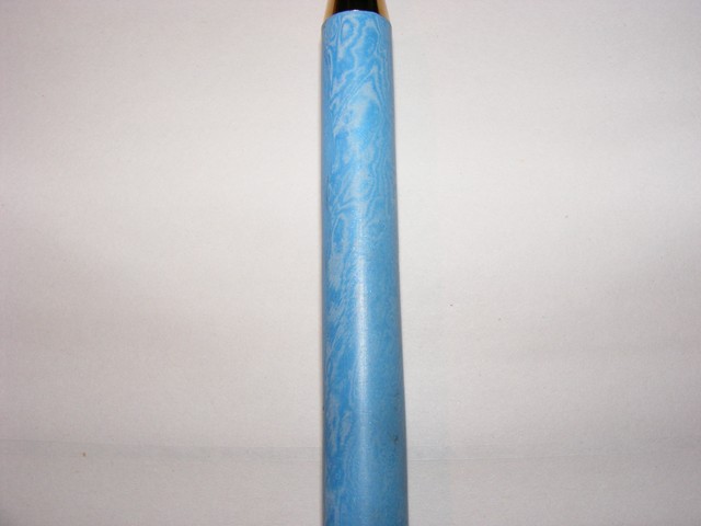

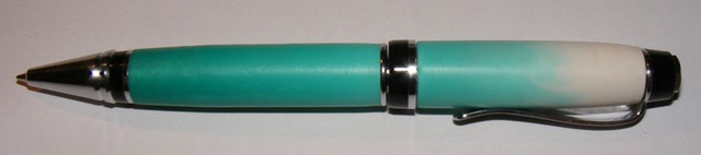

    I came home and confiscated one of LOML's glass cutting boards and grabbed some razor blades and started playing.
    Later I tried my hand at my first pen but made the layer of clay too thin and it lost the pattern that I had gotten in the clay. The first result was a VERY plane orangish tube that was immediately cut off the brass.
    But today, I did my second and third attempts and while far from perfect, I'm at least pleased enough to show them.
    First up is a pearl green/white blend that I threw on a cheap chrome cigar that I know will never go anywhere.
    Second is my first attempts at a Faux Mokume Gane in Blue pearl and white. The pattern is very subtle (and slightly out of focus in the first pic) but it definitely opens up possibilities.
    So tell me what you think, and feel free to ask newbie question since that's exactly what I am on this.
    Oh, so far 3 pens is a total of about a package of clay, maybe less.

    Those look fantastic.
    So is there anything under the clay, or is the entire body of the pen made of the clay?
    How hard is the stuff on your turning tools?
    Kinda fascinated. Not only are the turnings beautiful, but the entire process is pretty neat (if you ask me).

      just the brass tube that's part of the kit and the clay.
      After baking, it's not as hard as pottery, but it is very hard. I turned them with a skew and the sanded to final with ho problems. I would say they are similar in hardness to Acrylics. There are a couple clays that are supposed to be slightly harder, and take a polish a bit better that I may be looking into once I am ready to buy another batch.
