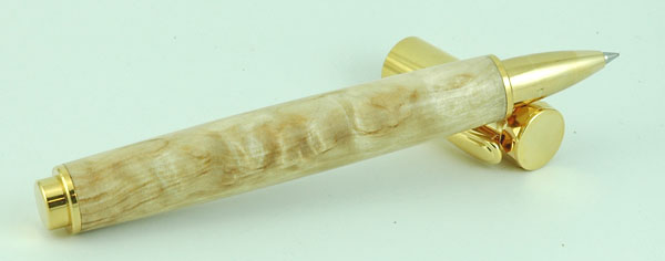

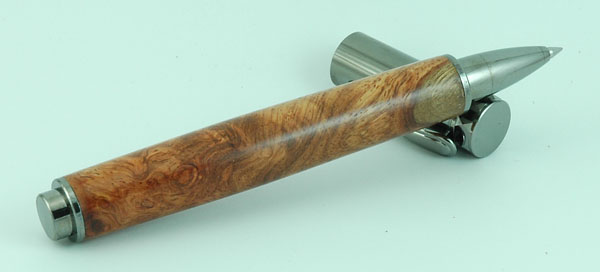

    I turned these this morning.
    Black T/N with Amboyna Burl and a Gold with Masur Birch. They are finished with 6 coats of blo/ca.

      Dick, I really like your combination choices.
      How do you like the Zen kits? I have turned about 10 of them and really like them but have heard others say they don't care for them.

        Lookin' good, Dick...
          Man, those are sweet!
            They have turned into my favorite kit to do and I carry one as my everyday pen. Love the way you can show off a beautiful piece of wood or acrylic on one.

                db,
                You're actually better off making pens without a mandrel. You just need a 60 degree dead center for the headstock and 60 degree live center for the tailstock. Then you use custom bushings that insert inside the pen tubes and mate up with the dead and live centers. Much more accurate than mandrels....
                Dick,
                Those are really nice looking Zens, I've done a few Zens in acrylic but need to grab some nice wood and 'give 'em a spin'....
