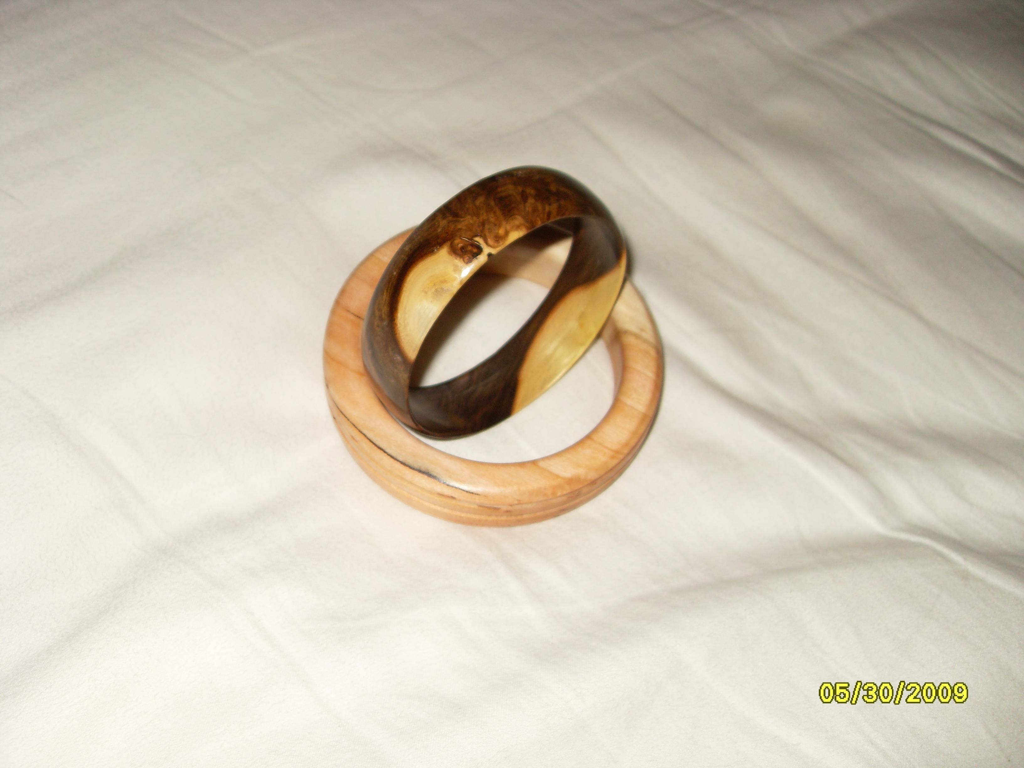

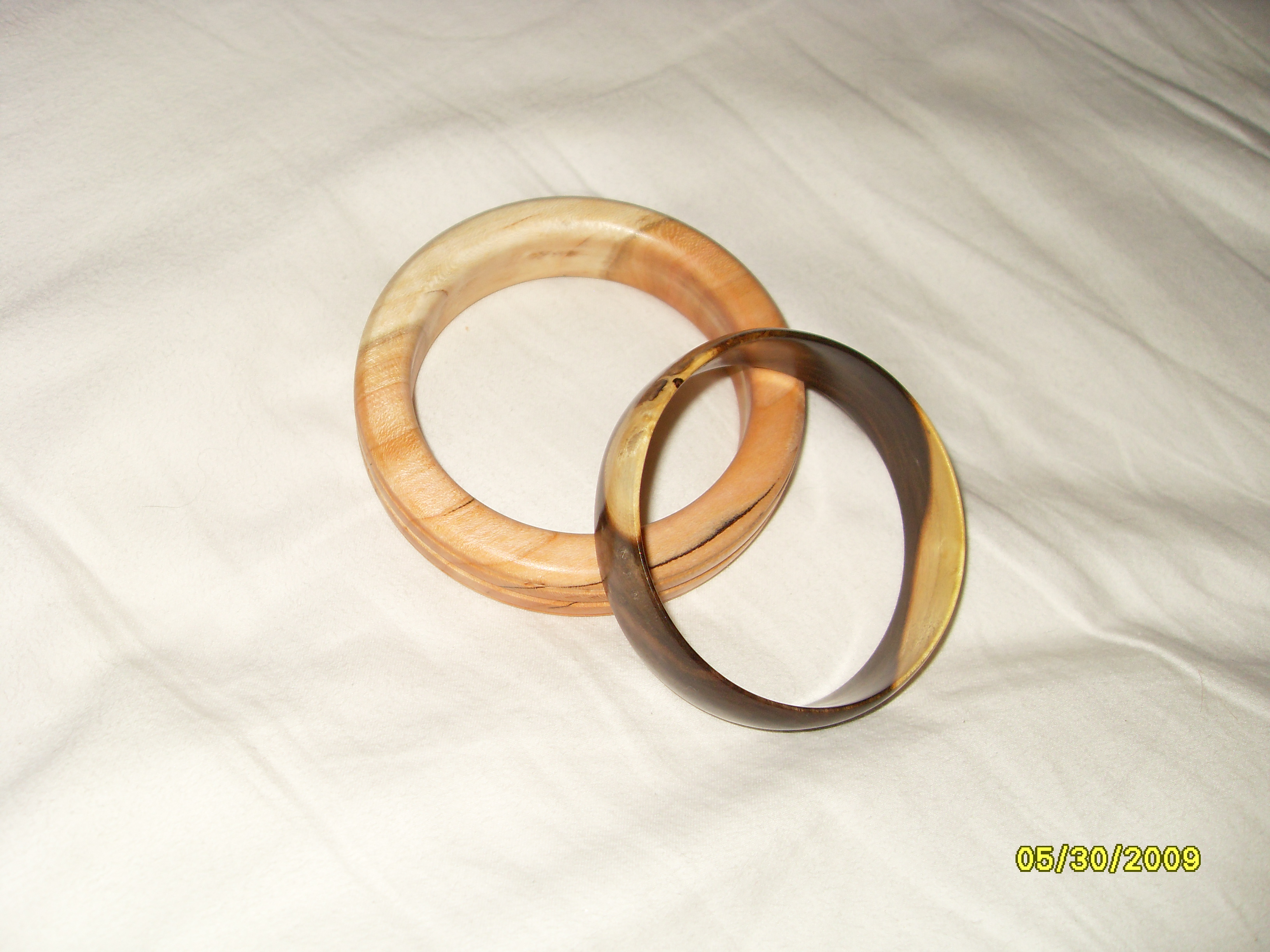

    I took my girlfriend with me the other day to WoodCraft and she was looking thru the turning books and saw a few bracelets that she liked and showed them to me. While she was at work today I thought I would surprise her so I made these two for her.
    One is Cherry and one is Texas Ebony.

    She of course loves them but I welcome comments and critiques from BT3ers.

    Oh, man, are you gonna get lucky tonight! Seriously, those are a couple of very nice pieces.
    Bob
      Beautifully done! I really like that Texas Ebony.
        I'm busy with the smoker tonight. But I might just have a chunk of mesquite large and clear enough for that... I think I am gonna get busy on the lathe...

          The Texas Ebony is really nice. I hope that finish is epoxy because being that thin might make them a bit fragile.

              Love the Texas Ebony.. I've never seen it before.
