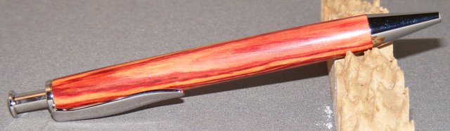

    After hearing horror stories about all the click pens available, I finally found one that people seem to think is a good one, so I got 5 and gave it a try.
    First is a Tulipwood Click
    Second is my favorite wood, Celtic Irish Bog Oak.
    Both are on Platinum Click pens which are about as easy to make as you can get. Press in the nib (which unscrews to replace the refill) and press in the plunger using a piece that slips over it to prevent damage.

    Looks nice. Model and source? Parker-style refill? Extension needed?
      Looks good Mike.
      I have been wanting to try that kit.

        What kit is that? Where from? Thanks!

            kit is from LauLauwoodworks
            http://laulauwood.com/pen-kits.asp
            There really are just 7 items in the kit.
            1 brass tube (takes a 3/8ths drill bit and a long one would be nice, I used a regular)
            1 nib
            1 nib insert (gets pressed into the tube and is threaded for the nib)
            1 clip (rather nice one)
            1 plunger assembly (that gets pressing into the other end)
            1 assembly tube (slips over the plunger while pressing it into the blank, preventing damage, then is tossed out)
            1 PARKER refill
            Aaron sells Dayacom kits, same as CSUSA. His version of the Euro looks real nice, but I haven't made it yet.
