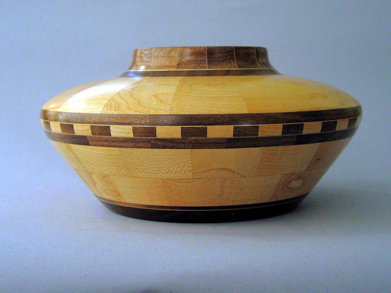

    This is an interestng item to make and in some areas it presented me with a challenge.
    It measures 4 inches high, 4.5 inches in diameter and is made from Eastern Canadian maple and Australian jarrah.

                  Take a look at this website for information how to make open segmented vessels.
                  C:\Documents and Settings\Owner\Desktop\Making an open-segment bowl.mht
                  It requires that you make a jig first along with some form of reliable indexing system. After that it's a matter of patience! The item is turned after about three layers are glued, then the next three, and so on.
                  The individual pieces were cut then sanded very lightly by hand to remove any bits that would affect the glued surface; other than that it's fairly straight forward and very satisfying.

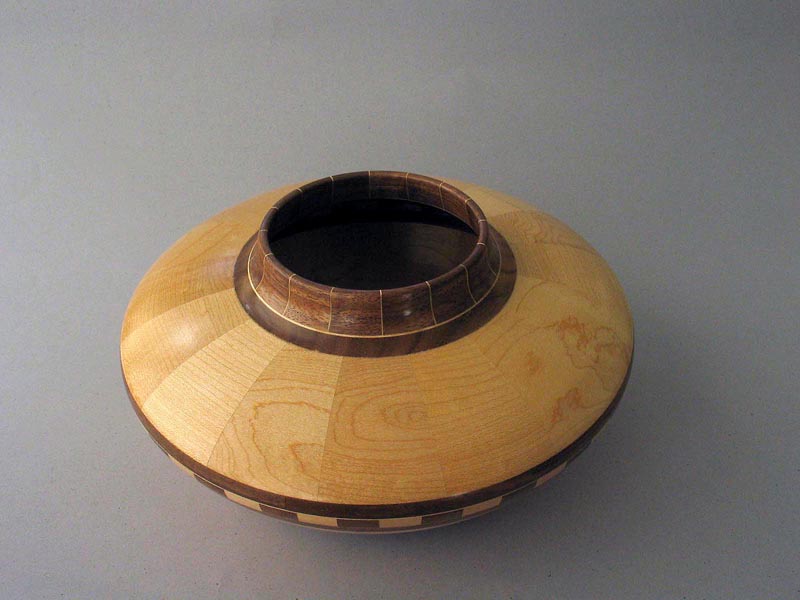

                  Attached is another of my vessels which contains 157 pieces and made from walnut and maple.
