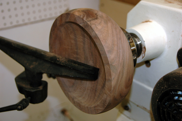

                      #25
                      Shallow bowl so far:
                      • gerti
                        • 2233
                        • Minnetonka, MN, USA.
                        • BT3100 "Frankensaw"
                        #26
                        Outside looks good! Just as a reference: For a bowl that size, dry Walnut, you can expect multiple trips to the grinder before the bowl is done.
