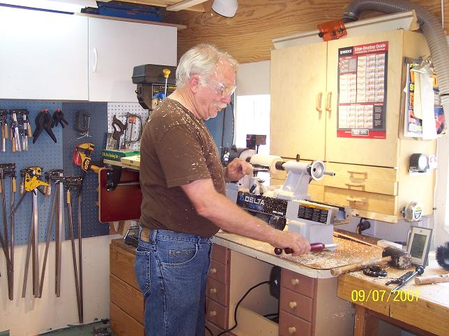

          Well the lathe got here about 1pm, day late, but it is here. Got it set up quickly and made a mess. Now I will have to go out after my haircut and clean all the preservative off it. To excited to get going so will get out the break clean and clean it up and wax it. Talking about instant gratification, turned down a limb it brough home yesterday from tree we cut down at church. Will stop and way home form hair cut and get some more. Will also stop by Borg and pick up a face shield. Will also have to get a smock to wear, talk about making sawdust. This is going to be fun. Another good deal beacuse of the people at BT3Central. Thanks guys.

            Hey, now that's a great picture of a new tool and in use already. You sound like you are having fun. Can't wait to see your first finished project. I came close to getting the LA200 but too many projects already.
            How about a review of the lathe after you get comfortable with it?
