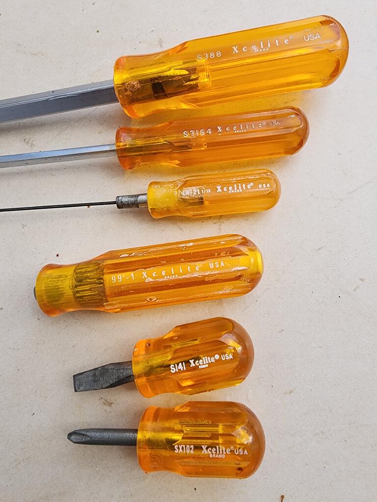

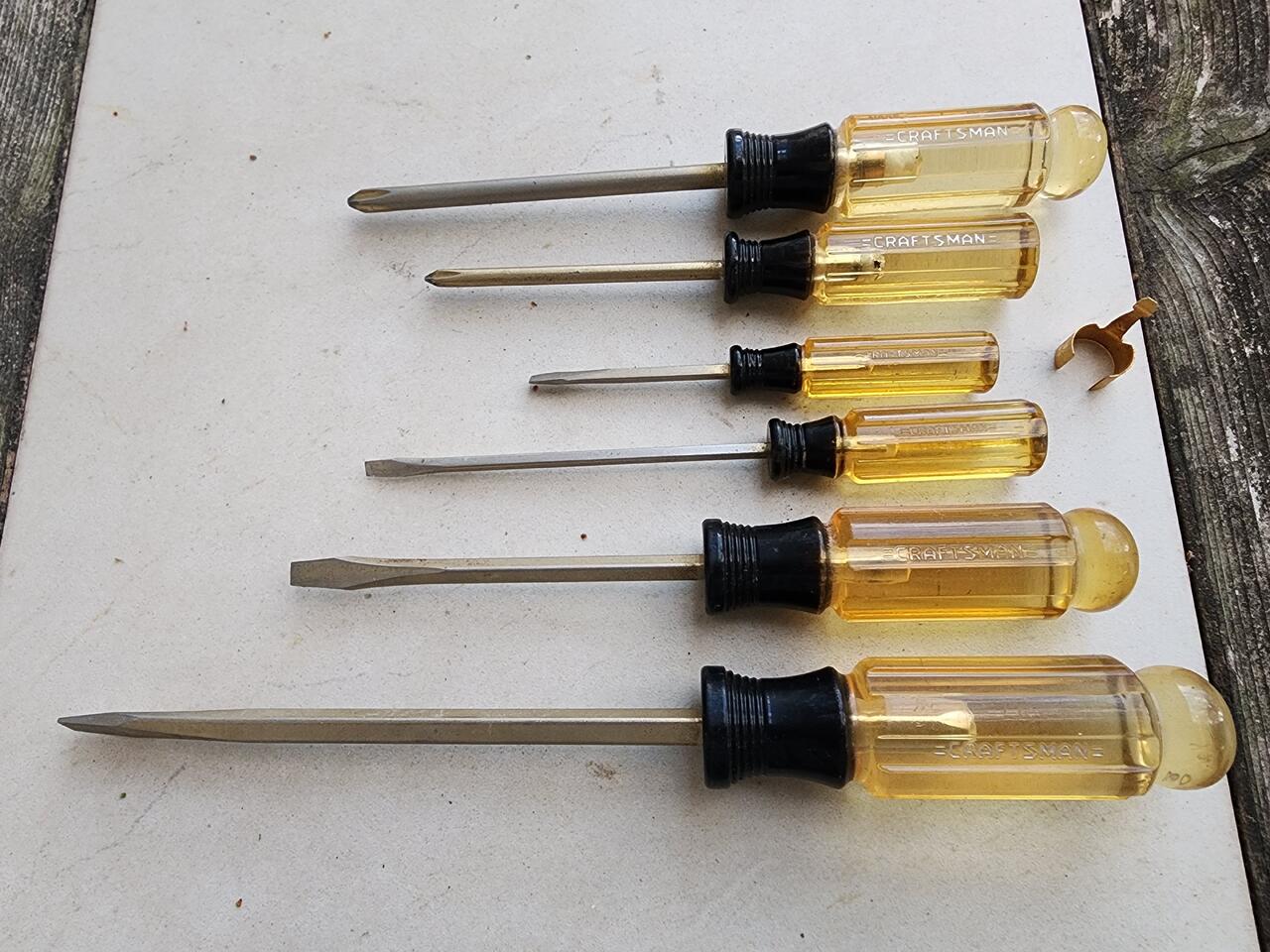

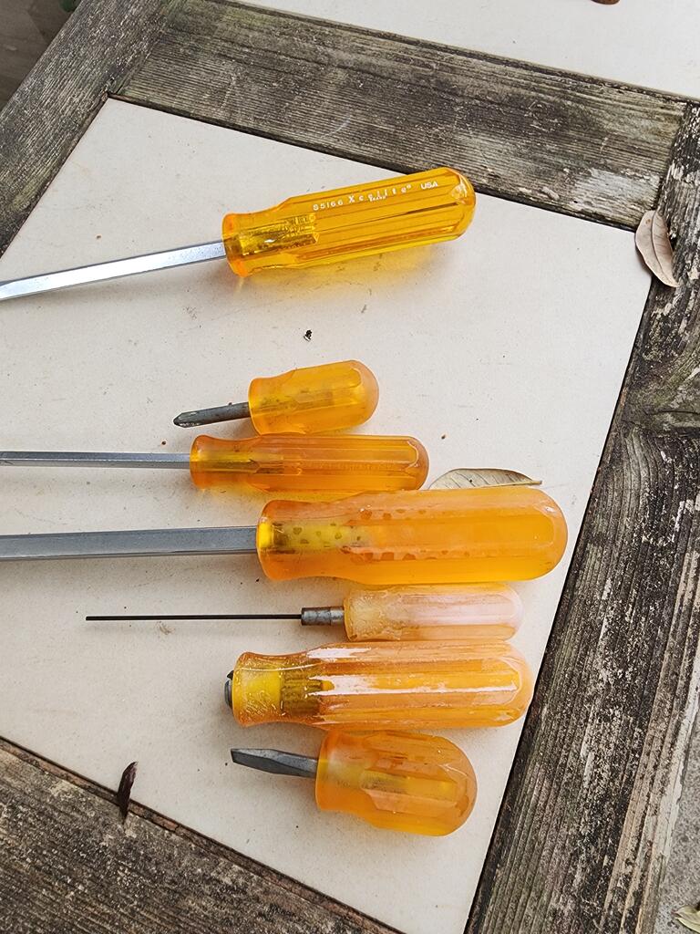

    So I tried it and it does make a big improvement, especially if the haze is not too bad. Soap & warm water, alcohol and then wax.
    Before (one at top is like new for comparison)
    Click image for larger version  Name:	20260226_101721.jpg Views:	1 Size:	155.3 KB ID:	862731
    After
    Click image for larger version  Name:	20260226_153432.jpg Views:	1 Size:	109.0 KB ID:	862732
