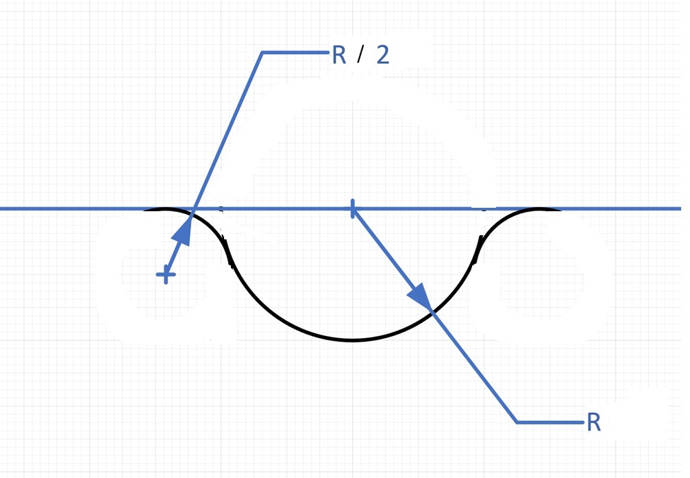

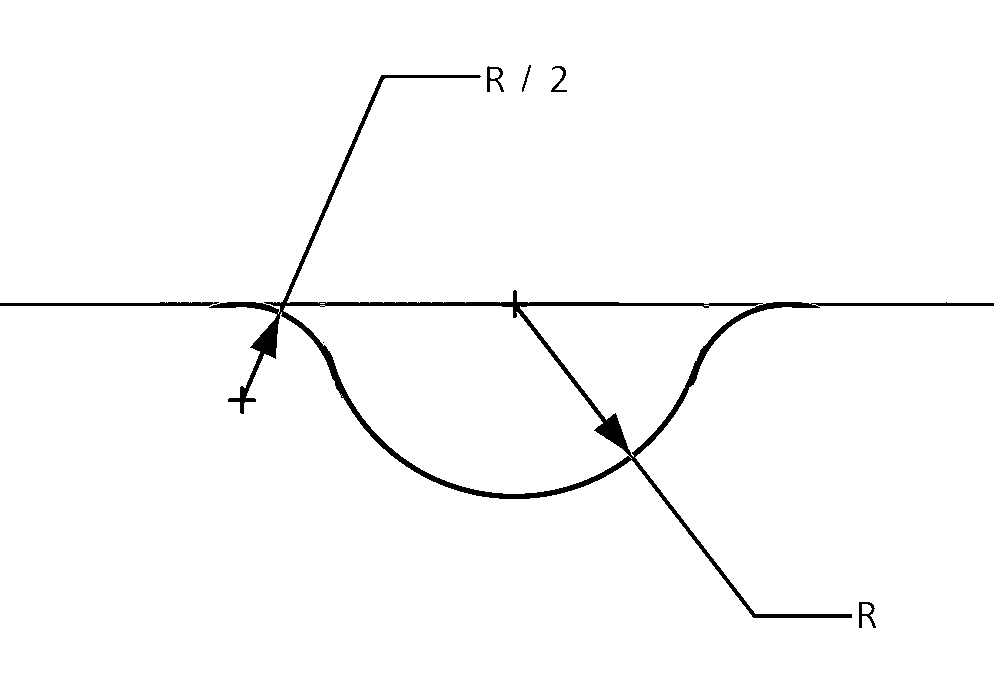

Is there such a router profile as this:
    • 22098
    Click image for larger version  Name:	my router bit idea mono.bmp Views:	0 Size:	87.2 KB ID:	862662
    With R= 1/4", or 3/8" or 0.5" this might make a good handhold or finger lift for the side of a small box. I can't find anything like it.
    With R=3/8" the bit would be 3/4" diameter and 3/8" cutting depth.
    To make a stopped groove it would be nice if it was plungeable.
    When you use a bull nose bit to make fingerlifts it leaves sharp edges on your fingers. the secondary radius removes that.

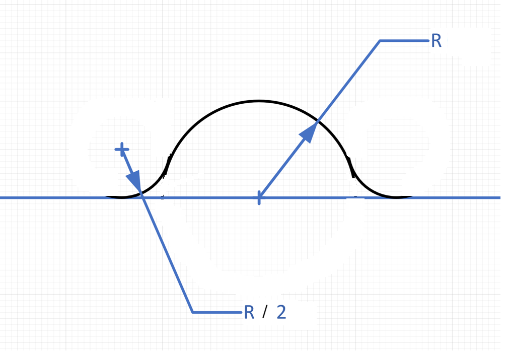

    • 22098
    Ah, I found that you can use the search words "ogee groove bit"
    and get ones like this - they don't have two radii, both the same, but closer to what I want.
    No edge forming bits with bearings or rail and stile ogee bits.
    Click image for larger version  Name:	image.png Views:	0 Size:	233.9 KB ID:	862664

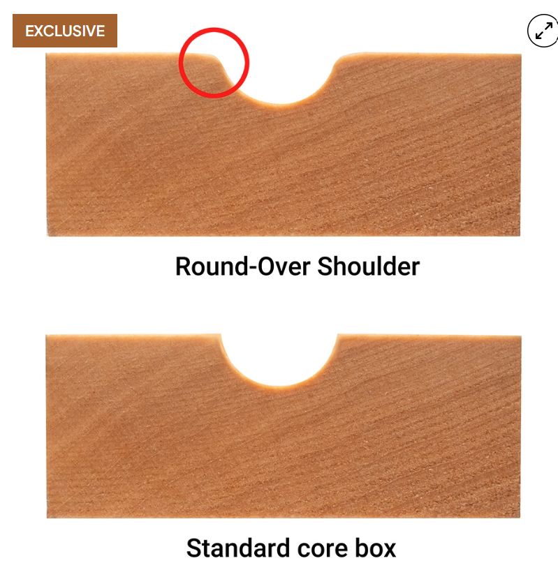

      A couple of people at Reddit pointed out that Rockler and Woodpecker offer juice groove bits similar in profile.
ID:	862668R2 is much smaller but achieves the rounded shoulder I was looking for.
        • 22098
        what I was looking for:
        Core box groove with softened shoulders.
          Seek and you shall find - Sometimes!
