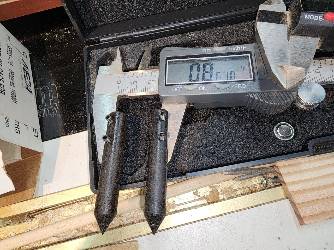

    Zero your calipers first. You clamp them to the jaws of your calipers (dial or digital) and use the set screws and supplied Allen key to lock them in place. They are 3/8" diameter and the groove depth is machined to be at the centerline of the gage. So closing the jaws so the gages butt each other results in 0.375" (on mine I got .377-.378)
    Now you can measure the distance between holes accurately as long as they are more than 3/8" apart. They have a conical tip so they will self center in most any holes up to 3/8" dia. I'd judge the accuracy to be +/-.003". The points of the gage tips should be right directly below and centered on the measuring face of each jaw.
    I just used them to measure the spacing between mounting holes on my router base.
    They go on and off fairly quickly... you just have to remember to set the zero before installing.

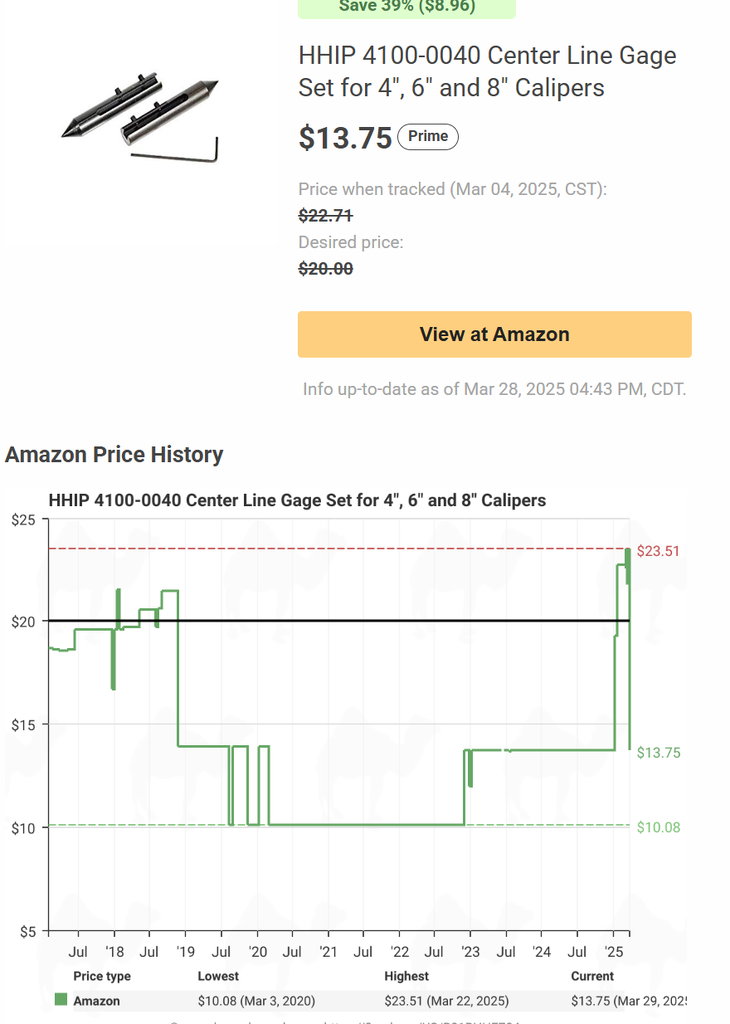

                • 22034
                Camelcamelcamel (Amazon price watching website) just informed me that the price of the gauges dropped to
                $13.75 at Amazon from the high of $22+ right after I posted the link.
                Good price if you don't want to deal with eBay or want fast delivery.

                  • 22034
                  Here used it again!
