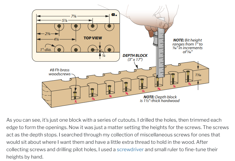

    • 22109
    detail from their web page
