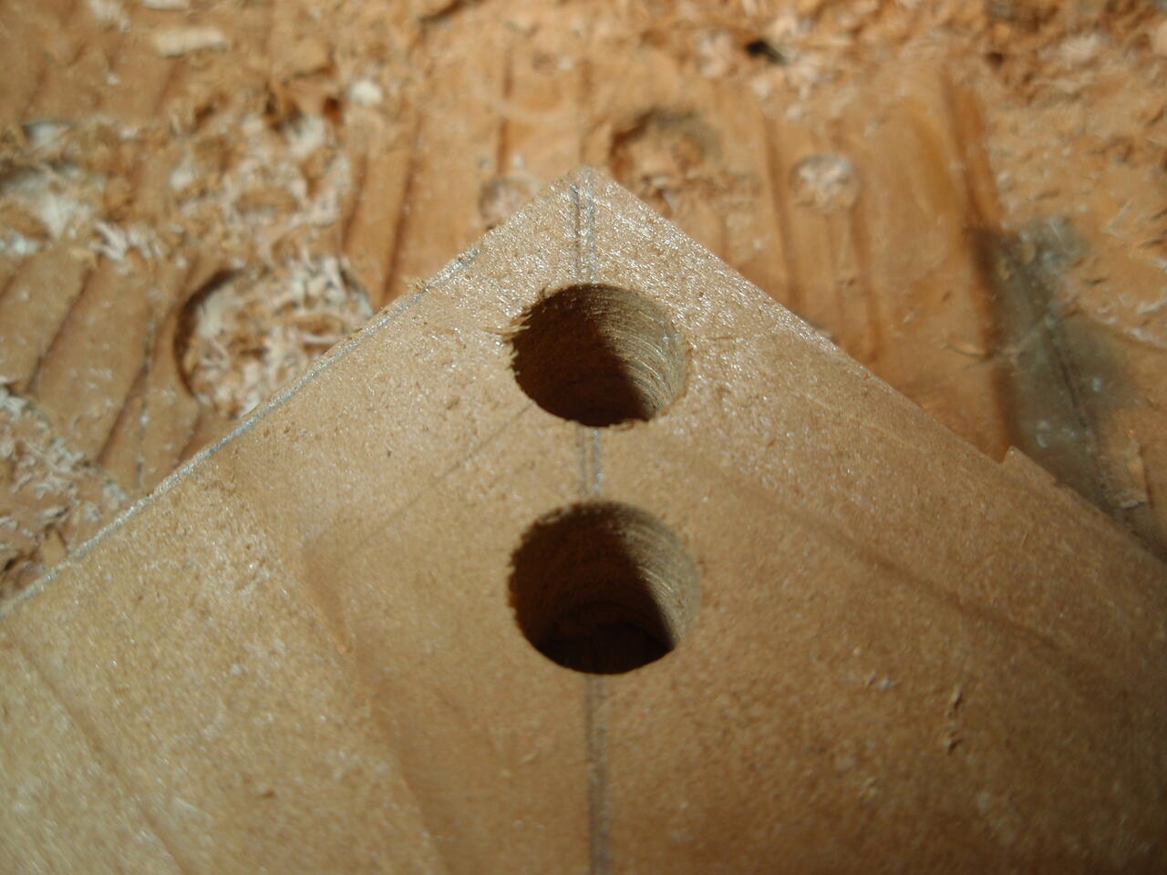

    Second pic, Exit hole with a slightly chewed up backer board.

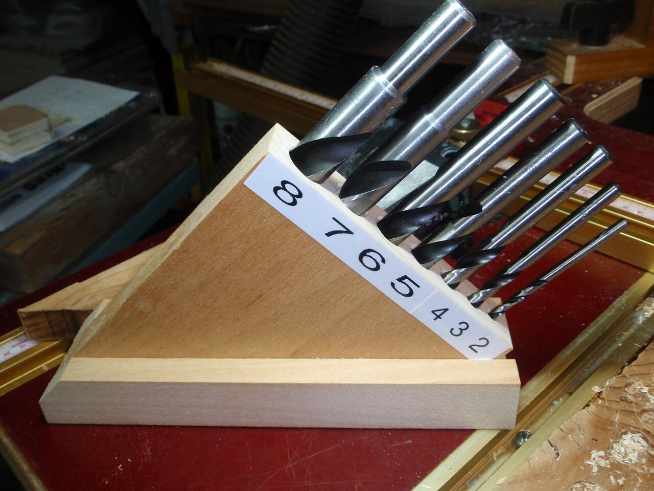

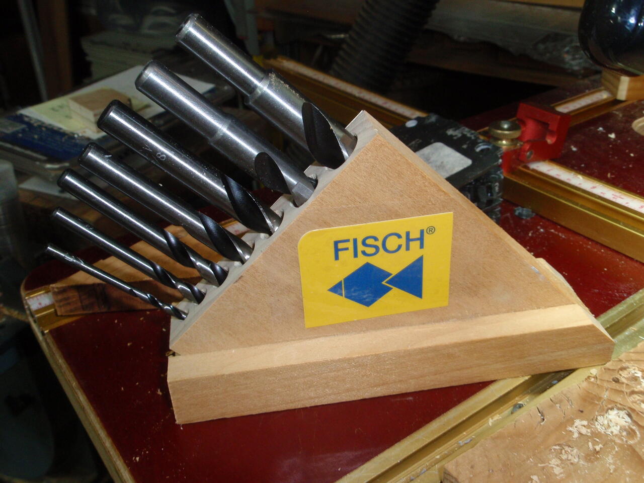

    Set of bits in the holders I made for 7-bit set, Sizes in 16ths.
    Click image for larger version  Name:	PB140042.jpg Views:	0 Size:	145.6 KB ID:	856963 Click image for larger version  Name:	PB140043.jpg Views:	0 Size:	154.9 KB ID:	856964
    Conclusion - some new, sharp, Quality bits do make a difference.
    In the past, On projects where the lack of hole tearout was important, I would drill to the point where the brad point center would just poke through, then flip the work over and place the brad point into the tiny hole and make a second entry from the back side with perfect alignment of the holes. While this works really well, it obviously takes more work so I am excited about better bits.
