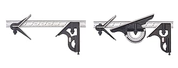

    I saw pointed out the other day that if you have a combination square set with a center finder, (like the ones pictured below)
    Click image for larger version  Name:	image.png Views:	0 Size:	23.9 KB ID:	856070​
    Then the center finder with the ruler scale removed can act as a saddle square to draw lines wrapping around a 90° corner.
    From sets like these:
    Click image for larger version  Name:	image.png Views:	2 Size:	28.4 KB ID:	856071​

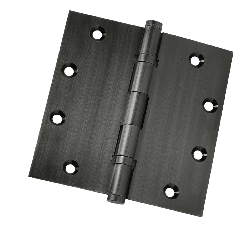

    Also I saw it suggested to used a door hinge as a saddle square, with the hinged part on the outside. ​Bent to 90 degrees.
    Click image for larger version  Name:	image.png Views:	0 Size:	285.8 KB ID:	856074​
