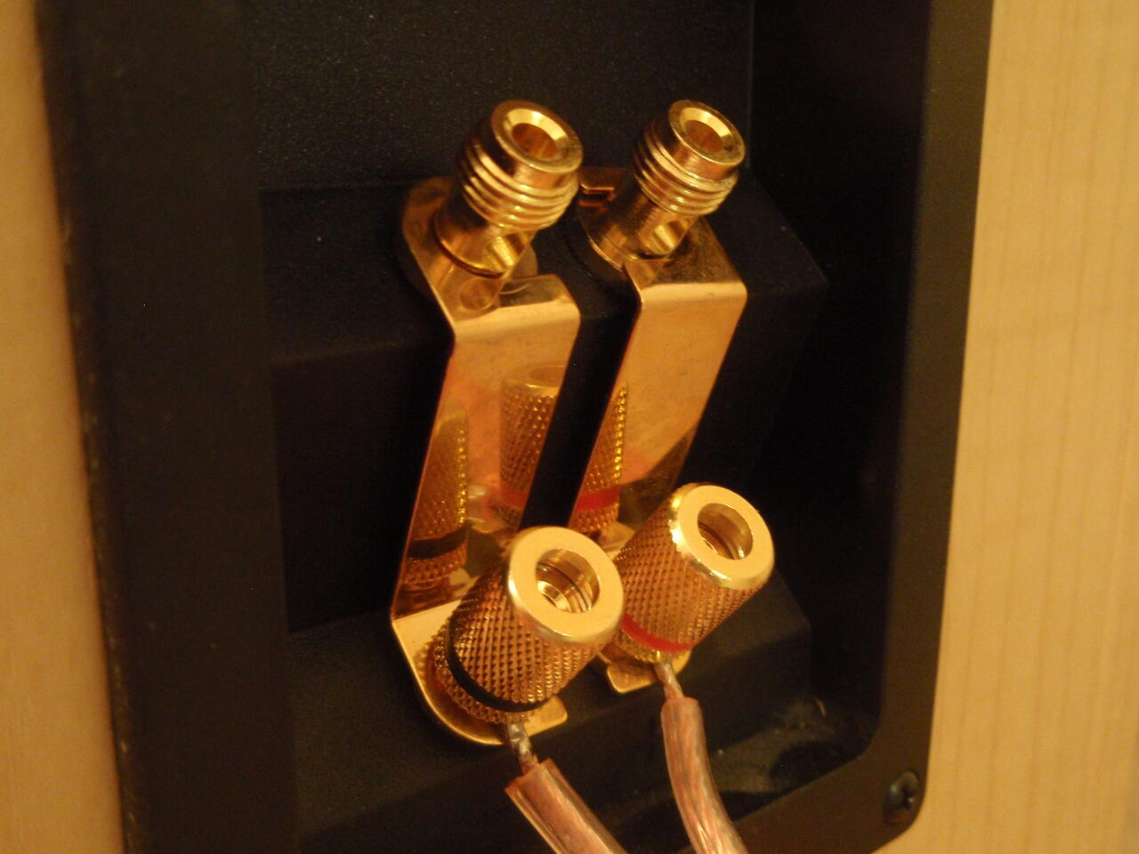

    I got these hiFi speakers which means they had Biwiring so it involves two pairs of binding post contacts for each speaker.
    They were from my moms which I set up in 2002 new and a few years ago she had a small problem in her retirement apartment where some contractors came in and moved and cleaned everything and put it back.
    Well I got these speakers back and one of them was missing two of the gold plated knurled nuts on the binding posts.
    Click image for larger version  Name:	P8201122.jpg Views:	0 Size:	109.0 KB ID:	852098
    So the normal jumper between the pairs is not making good electrical contact - I don't know how they were playing but it must have happened with the contractors because I surely did not leave it like that.
    So I figured the missing knurled nuts could be replaced with regular threaded nuts.
    So I looked at it and thought 3/8" so I tried some 3/8" standard 16 tpi nuts and they were about the right size but thre threads locked in about a turn. So a close look, the threads are finer so probably 3/8-24tpi standard fine threads. Metric passed my mind at this point and I thought, 2002, and these Infinity speakers are labeled Made in USA so I figured SAE/ANSI standards.
    A while later I have a pair of 3/8-24 nuts from one the blue box store but when I try them on the posts they only go on about 4 turns and lock up.

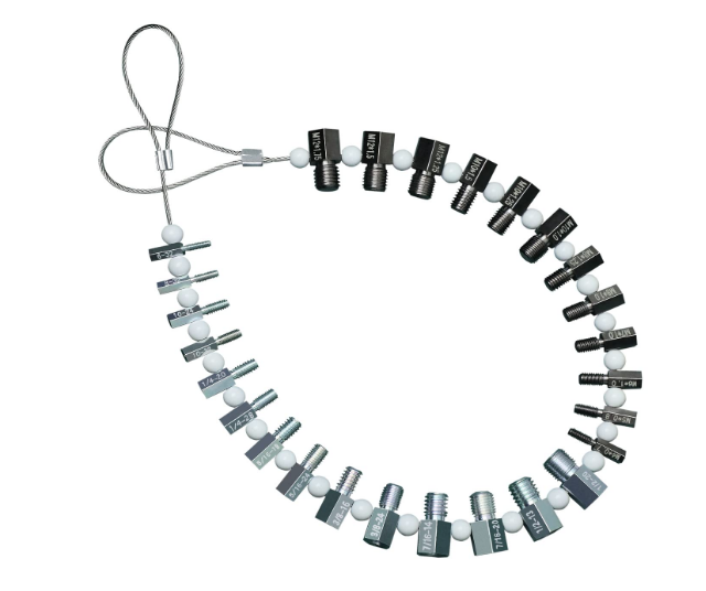

    So i order a thread checker from Amazon it comes next day and I check the nuts they are very rough and tight so I use my electric drill driver and run the 3/8"-24 tap I have in my HF set back and forth a couple dozen times with cutting oil and they now spin nice and freely on the 3/8-24 nut checker thread.

    After another day it dawns on me that maybe its metric after all. I check the knurled nut from the other post and it spins all the way down the M10 x 1 mm thread on my nut/bolt checker.
    Yesirree. 24 TPI and 1 mm (which is 25.4 TPI) are so close that quite a few threads go on OK before it jams.

    Fortunately I had the bug midway through this to order this with both metric and SAE:
