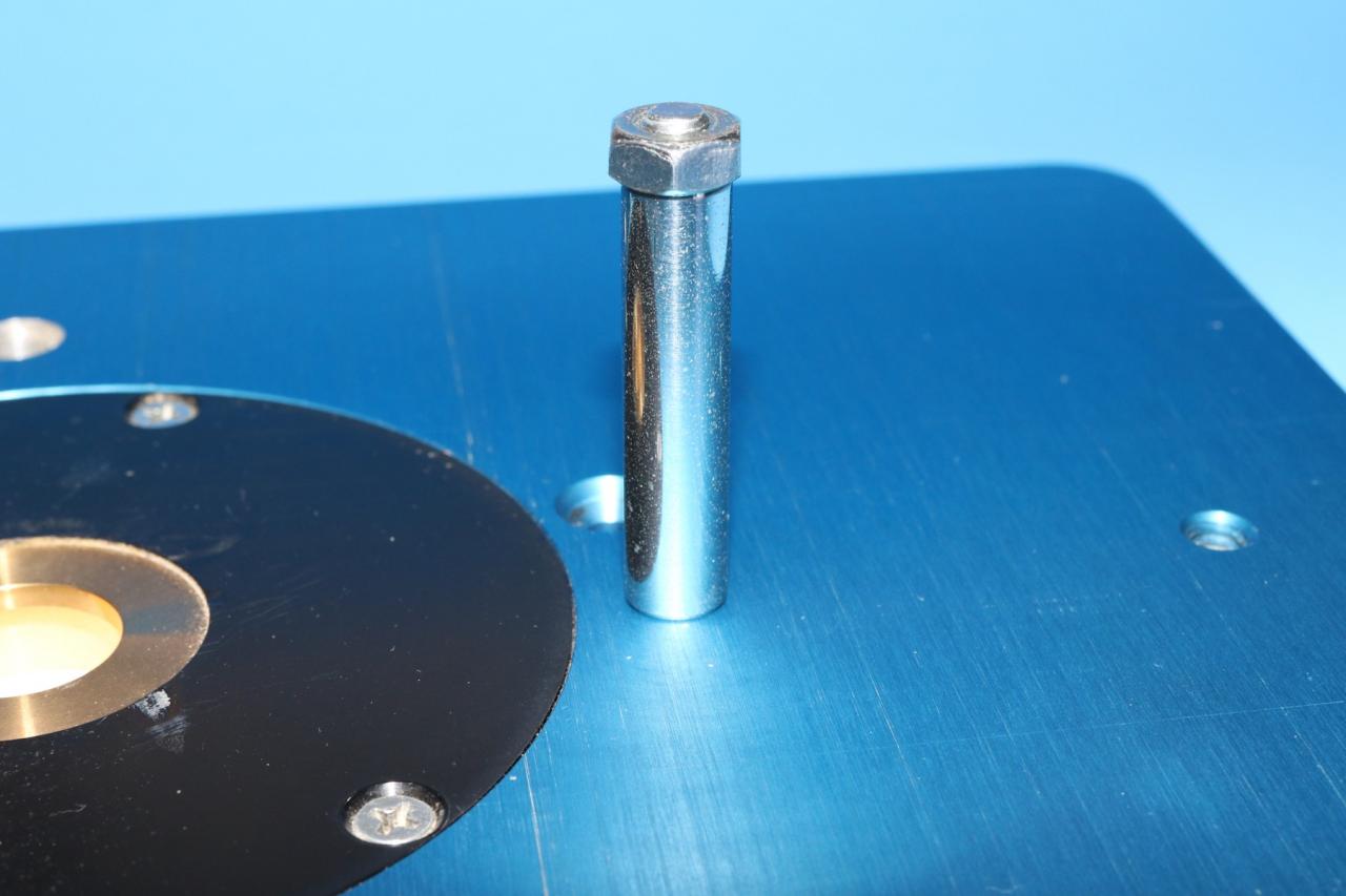

    My old router insert had location for one, but when I installed the new plate with the router lift it did not have a starter pin (AKA router safety pin) location.
    I'm thinking about drilling one, a 1/4" hole is needed just outside the red insert circle.
    I have both a brass pin and a DIY pin I made.
    Do you guys use a starter pin and where do you have it located.
    I'm thinking about 4 o'clock where my old one was located.
    Any comments or advice?

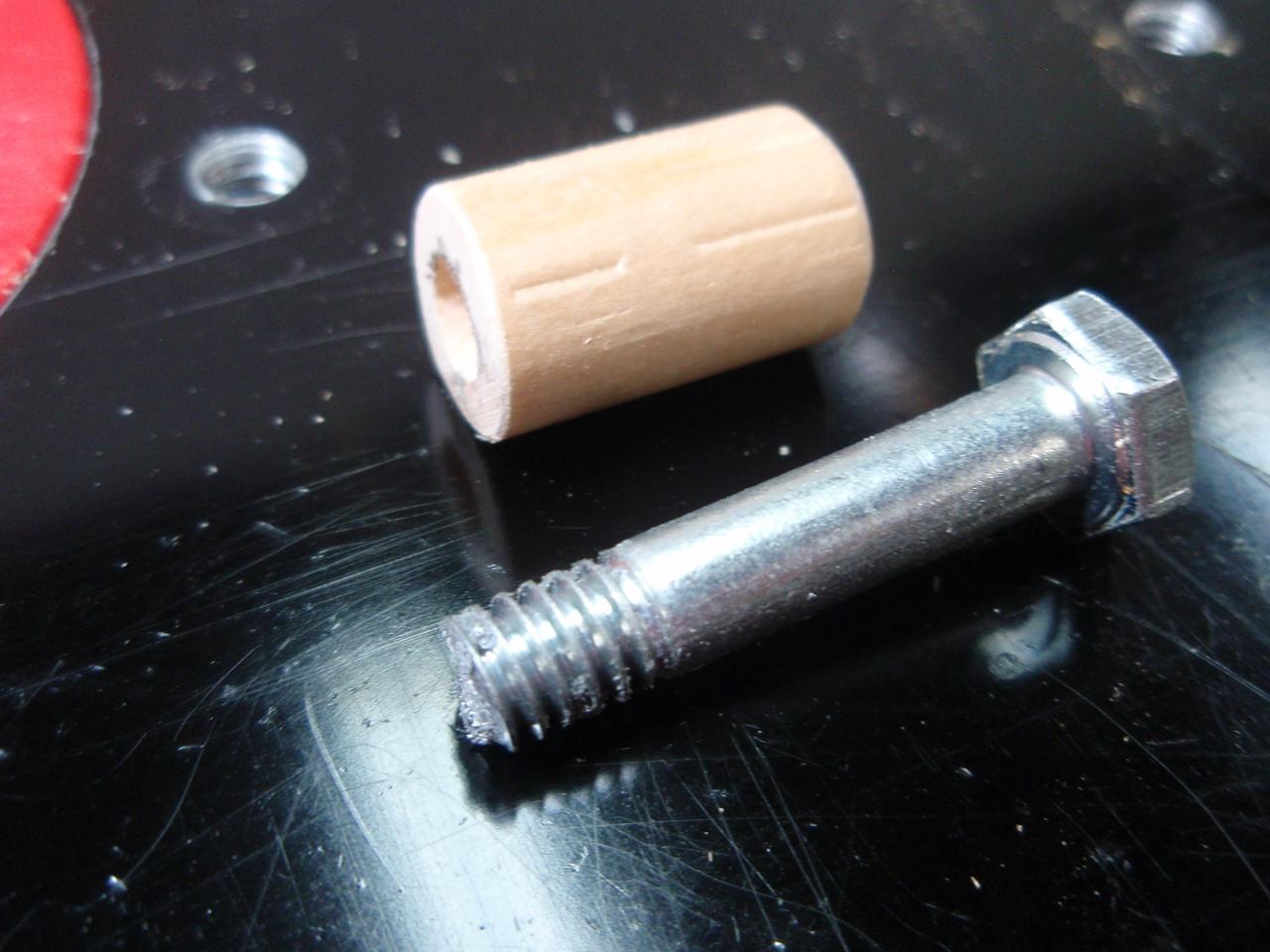

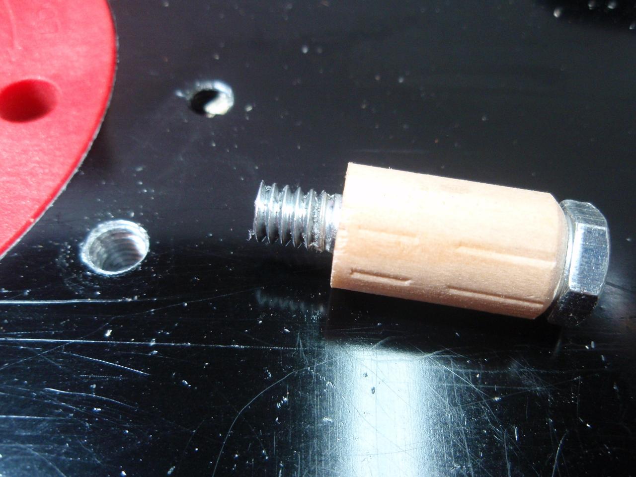

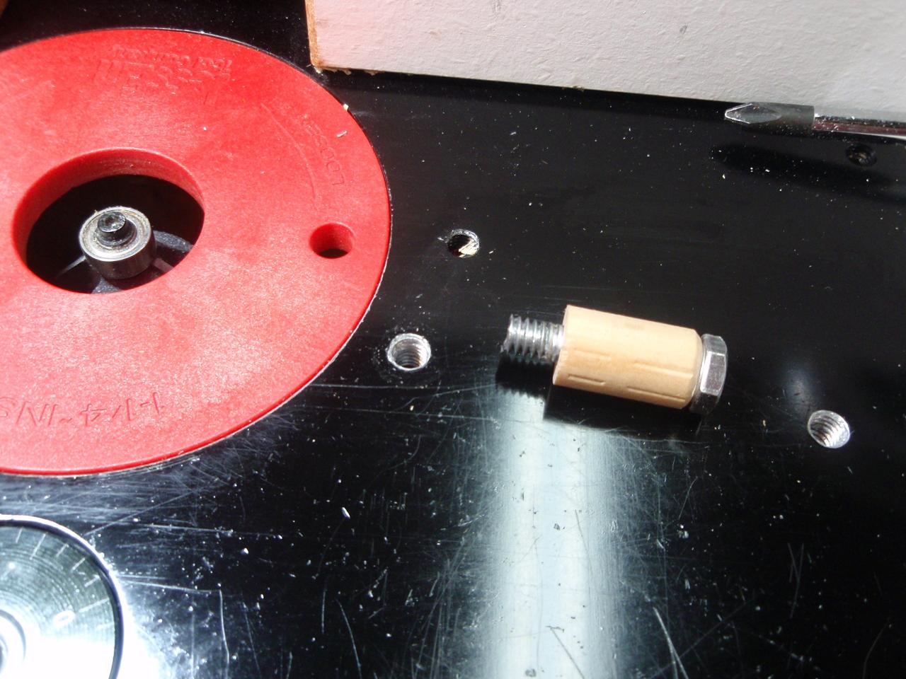

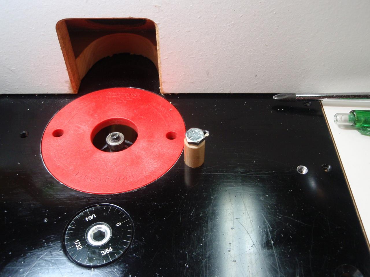

                OK, I decided to put in threaded holes.
                I thought the plate was phenolic but upon drilling it was aluminum.
                Anyway the popular pins are threaded 1/4-20. I made real sure nothing was below and marked two points, one for a near and one for a far pivot, on the right side.
                I ordered the Rockler threaded pins, but they are a couple of weeks backordered so I said hey I can make this so I took a bolt that was partially threaded except for about 3/4-1" and cut a 1/2" dowel and drilled it through 1/4", and reamed it until it slip fit the bolt shank. The length was just a hair shorter than the unthreaded shank so it would not be compressed but could spin when the shank bottomed out to the threaded hole entrance.
                I left about 6-7 threads to engage the plate and cut off the end of the bolt.
                Here's a trick... when cutting off a bolt to make it shorter, thread a nut to the head side of the bolt from the cut point. After cutting, running the nut off the raw cut end will straighten out the damaged cut threads and make them easy to start in a good nut or threaded hole after cleanup. That's 40 years of experience talking.
                So I have a low friction rolling pivot pin and two locations for it now for my router table.

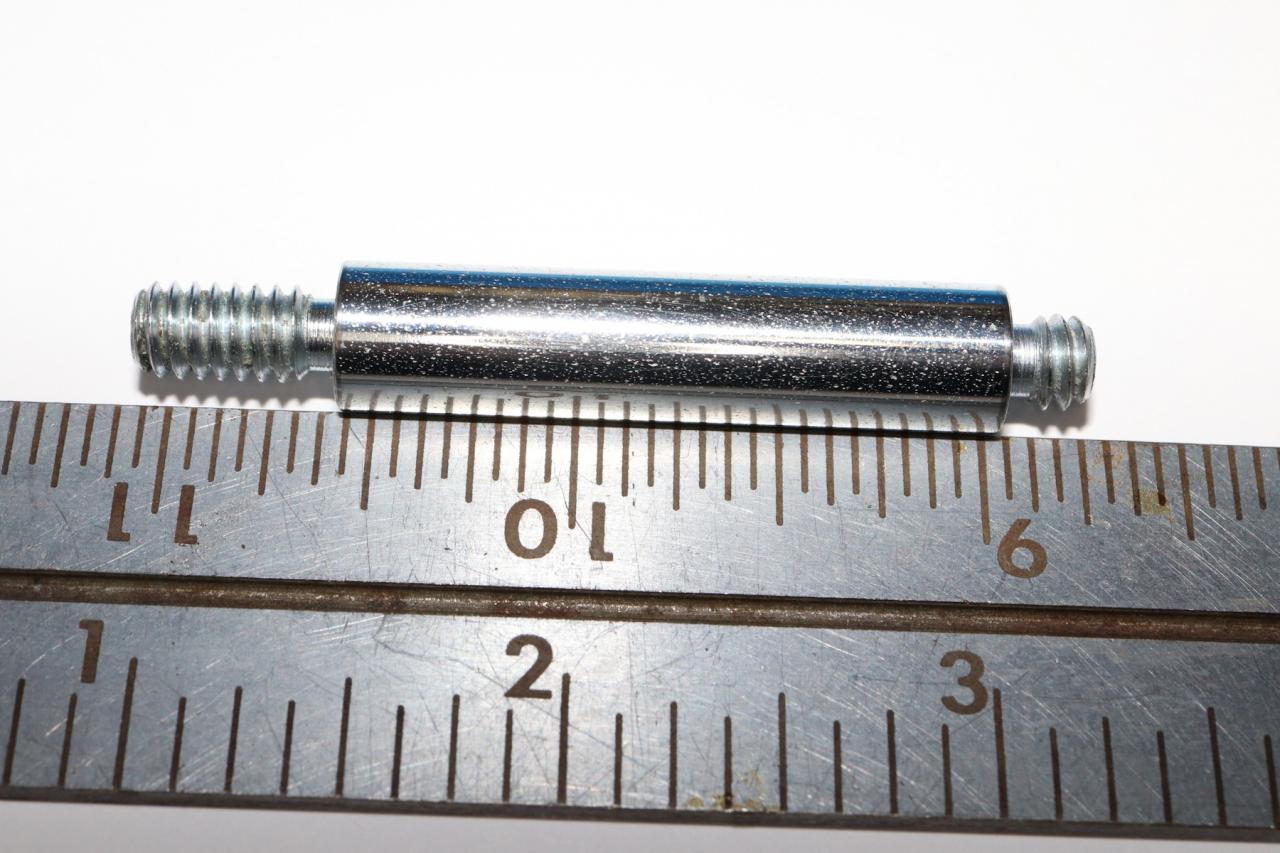

                  I can't remember where I learned that, but long ago someone told me, perhaps my Dad. If you have a 'die' that works best, but a nut is a lot handier most of the time. I just cut an aluminum 3/8-16 bolt to make a connecting stud for one of my tripod last years and remembered that great little trick. It's good that you passed it on!
                  Still haven't found my starting pin, it will turn up but it's frustrating when you misplace such things. I'm missing a small box of such router accessories and I've spent a couple of hours looking. I did look for one on the internet and they all seem to be rather short at just 3/4 inches. I may be wrong, but I'm sure the one I originally got from Rockler (I think it came with the aluminum plate) was about 1-1/2 to 2-inches after the thread. Your example is probably the easiest path to having a new pin. I'm not sure I would want a short one.
                  Thanks,
                    I'm pretty sure a 3/4" one is every bit as good as a 1-1/2 inch one. I don't think the extra height really helps any.
                      • 2812
                      You're right, after I gave it some more thought, I don't see the advantage of a taller starter pin. Like I said earlier, I've only used the starter pin a couple of times as most everything else I've done on the router table has been against the fence. My memory just recalls a longer pin, which someday I will find and probably prove myself wrong!
                        • 2812
                        Found IT!
                        So, as things usually go for me, I stopped looking for my router starting pin after spending a couple of hours looking here in the basement and out in the work shed. So yesterday afternoon I was cleaning up some stuff in the shed and there it was, with one of my tool bags sitting on top of the router accessories box.
                        It wasn't as long as I had remembered in my previous comments, but still it was about an inch and a half long and threaded on both ends. I keep it stored with three nuts on the longer threaded end and one nut on the top, shorter thread end, in order to protect the threads when not in use. Here is a couple of pictures with my router plate removed from the table.
