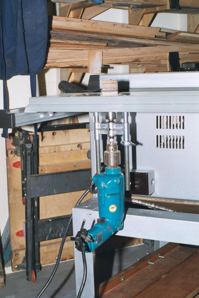

      Click image for larger version  Name:	009_5.JPG Views:	0 Size:	94.2 KB ID:	837957Click image for larger version  Name:	010_4.JPG Views:	0 Size:	68.3 KB ID:	837958I have an old PortALign drill guide that has a 2 1/2" hole in the base. I have it mounted on a plywood add on base that can be mounted under a BT3000 accessory table or clamped to the work piece. I used it to drill the dog holes in my bench. I use it with a Makita corded 1/2" drill. The newer PortALigns have an adjustable base for angles, but my 30 some year old one is fixed at 90 degrees.

        My first thought was what MPC said, then I saw Jim's. I used to have one of those guides and used it often, but I gave it to a son in law. That guide was sure handy but I got a DP and thought I would not need it any more. Boy, was I wrong.
