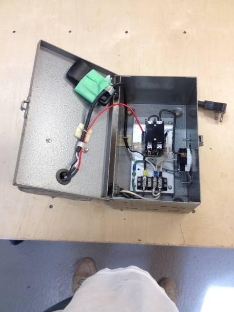

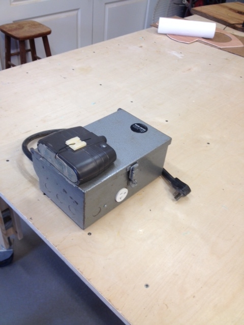

    Have you opened up the Shop Fox switch box to see if it has a magnet starter switch inside that could be re-used? I re-purposed an air conditioner magnet starter switch with a Christmas light remote control for my old dust collector remote. The only problem I had with it was my oversight in using a light remote with dawn to dusk. Occasionally it started my dust collector on its own when the sun went down and it got dark in the shop.
      • 3791
      Photo of my home made remote for 112-120 dust collector. I made this out of an electrical box that I picked up at a yard sale for a dollar or two, a Christmas light remote, probably $5 clearance after Christmas and a $10 contactor from Amazon. It works great and will handle 30 amps. The only problem is the light remote has the dusk to dawn feature and if I pushed the wrong button on the remote it could start up as soon as it gets dark in my shop! Nothing a piece of black elec tape over the eye didn't solve.
