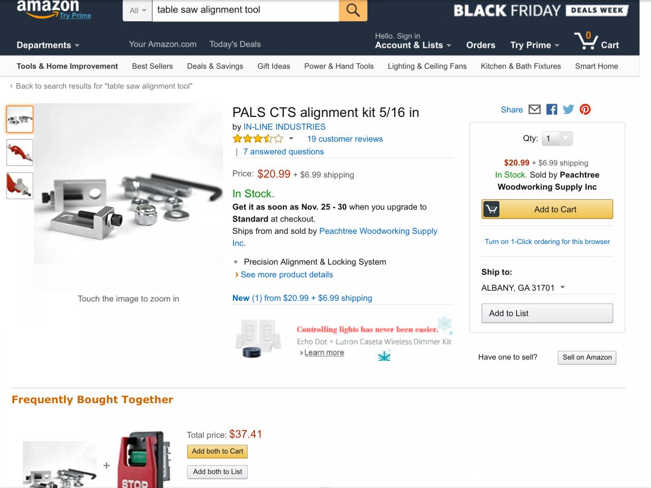

    It might be time for bearings. My powermatic didn't seem to want to stay aligned, after several attempts I found Edward Bennett s site tablesawalignment.com and joined his site. ( for some reason the site doesn't seem to be working right now, maybe it is still active) he has a really good instructional for aligning the saw. He sells a kit to assist in the alignment that makes it so much easier and for some reason after the kit is installed it seems to stay aligned? Since his site is not working maybe this photo of peachtrees alignment tool will help you, it looks the same as his, probably is mfg'd by Bennett.

      Thanks so much capncarl for your time and advice. I have learned since my post that the table top may need to be adjusted. I'll look into that first. Hope to be making some sawdust soon!
      jeff
