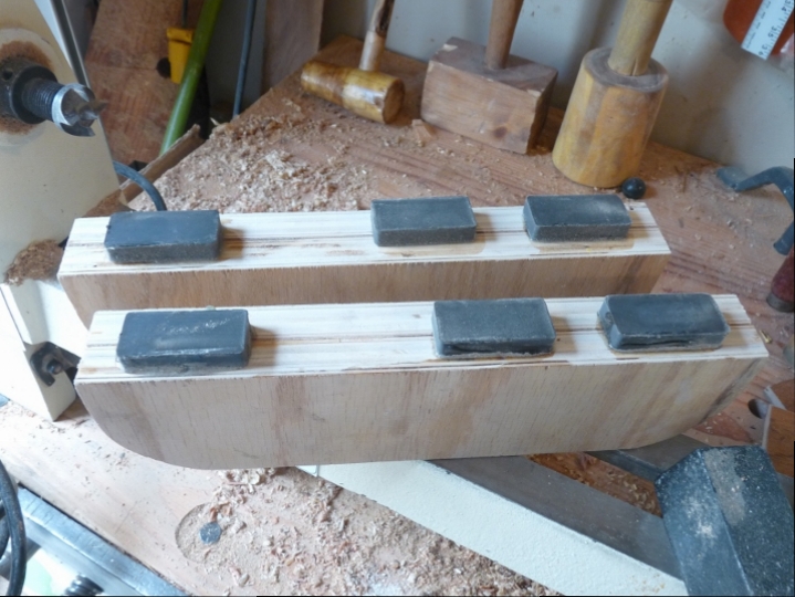

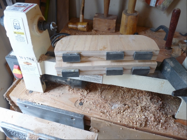

                    Built a magnetic alignment pair of gauges for the jointer from an article long ago. What you need is 6 magnets, two short (8 - 10 inch) straight boards and some epoxy.
                    Set 3 of the magnets on the jointer outfeed table in a straight line. Two of them fairly close together and the 3rd near the opposite end, all with the length of your boards. Put a little epoxy on the top of each magnet and set the edge of one of the boards on top with some weight. Do the same thing with the second board and 3 magnets. Wait the appropriate time for your epoxy to cure. Look at the attached pictures to get a better idea of what mine look like. Because you used the flat top of the jointer, all the magnet bottoms should be exactly on the same plane.
                    To use: set the two gauges so that the single magnet is centered over the blades while the other two magnets keep everything secure. Put one gauge on each end of the blades. With a blade loose and directly under the magnet, it should be attracted up into the bottom and you can tighten it in place. Make sure it doesn't lift or drop as you tighten it down and make sure the edge is at its highest point. Do each blade and you should have the top of all the blades in perfect alignment with the outfeed table. Slowly rotate the blades and they should just "kiss" the bottom of the magnet at both ends.
                    This jig does the same as the commercial version.
                    This all presupposes that you have an older jointer with adjustable blades. The newer ones seem to have throw-away blades that are fixed position or helical blades.
                    Hope this helps.
