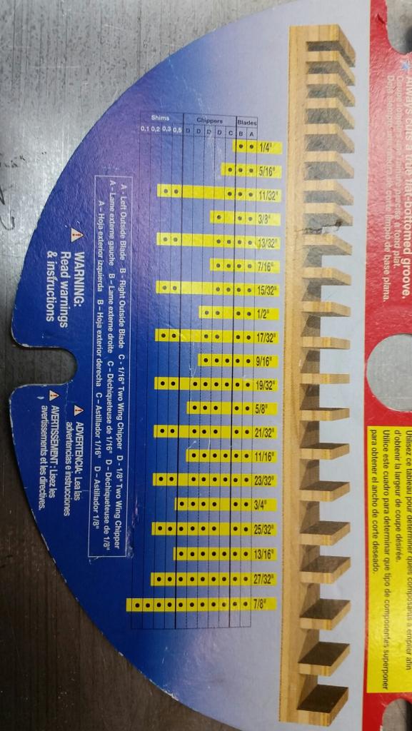

    Several years ago I was gifted the SD208 dado set.
    I already had an inexpensive set, and I normally use the router table for dados and grooves, so I hadn't opened the SD208 until yesterday.
    I have some confusion about the chippers I have with the set.
    The Freud site shows the chippers included are two 1/8" and one 1/16", and a set of spacers.
    My set has four chippers that measure 0.275 and one that measures 0.143.
    I needed to cut some 7/16 dados and the included chart shows I need the outer blades and one 1/8 shim and one 1/16 shim.
    Anyone have any idea how my set could have these 'oddball' chippers?

    Do you have the black oxide version, or the chrome version? Freud changed the design a few years ago and discontinued the black oxide version. The re-design changed the number of chippers and spacers. The chart on Freud's website looks to be for the chrome version.
    You'll have to rely on the chart on the blade case, if you have the chart.

      I have the older version apparently, someone on SMC mentioned there was a replacement.
      Funny thing is, the chart shows info for the new version with 1/8 and 1/16 chippers.
      I'll call Freud tomorrow for a chart for what I have.
        Hi Ken, hope this helps. I have the SD206, but your set sound identical to mine except for the diameter.
        Mine are also called 1/8" and 1/16" and measure oversize like yours, but when you use the side chippers, the teeth will overlap giving you 1/8" and 1/16" for the 2 tooth chippers.
        Paul

          Ken, I have the SD208 for many years back.
          Did you measure the width at the carbide or the body of the chippers?
          The carbide will always be wider than the body (plate) of the chippers.
          You have to be careful and place the carbide tip between the gullets in the side cutters and offset the chippers by about 1/6th of a turn at least to make sure that the carbides of the chippers are not pressed between the side blades of the other chippers. the bodies of the chippers should be flush against each other and the end blades.
          This ensures that the width of each added chipper is the body width of the chipper and not the width of the carbides.
          In this case the .275 and .143 width of the carbides seems correct. The added width overlaps between chippers and side blades to ensure the chipper make a clean cut in the bottom of the dado.
          If you have additional shims of .005, .010, .020 then you can place them between any pair of chippers and increase the dado by that amount. The overlap ensures you wont have .010" or so ridges in the bottom of the dado.
          I have always found the chippers of 1/8" and 1/16th inch to accurately increase the width of the dado by that amount expected.

              As Loring mentions make sure you get the chipper teeth between the outer side blade teeth. I've messed up more than a couple dados by not ensuring this.
                I have the freud 6" set and its a similar situation. Basically just what Loring said, chippers overlap to create a cleaner cut :-)
