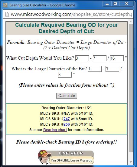

    Found a mildly useful web-based calculator at MLCS Woodworking
    You can enter the rabbet bit major diameter and the cut width desired and it will tell you the bearing size needed for that step.
    http://www.mlcswoodworking.com/shops...e/cutdepth.php
Name:	Rabbet Bit width calc.JPG
    It's always a bit complex even though its simple addition.
    Its the major cut size minus the bearing size divided by two but the units are often weird, for example my bit is 1-3/8" and there's a lot of fraction math and decimal conversions that are easy to screw up.
    Above, I needed a 7/16 rabbet and it tells me a 1/2" bearing is right... not obvious.
    This calculator allows putting in the fractional rather than decimal sizes (saves one conversion) and gives the MLCS part numbers for bearings if you need to order one.
