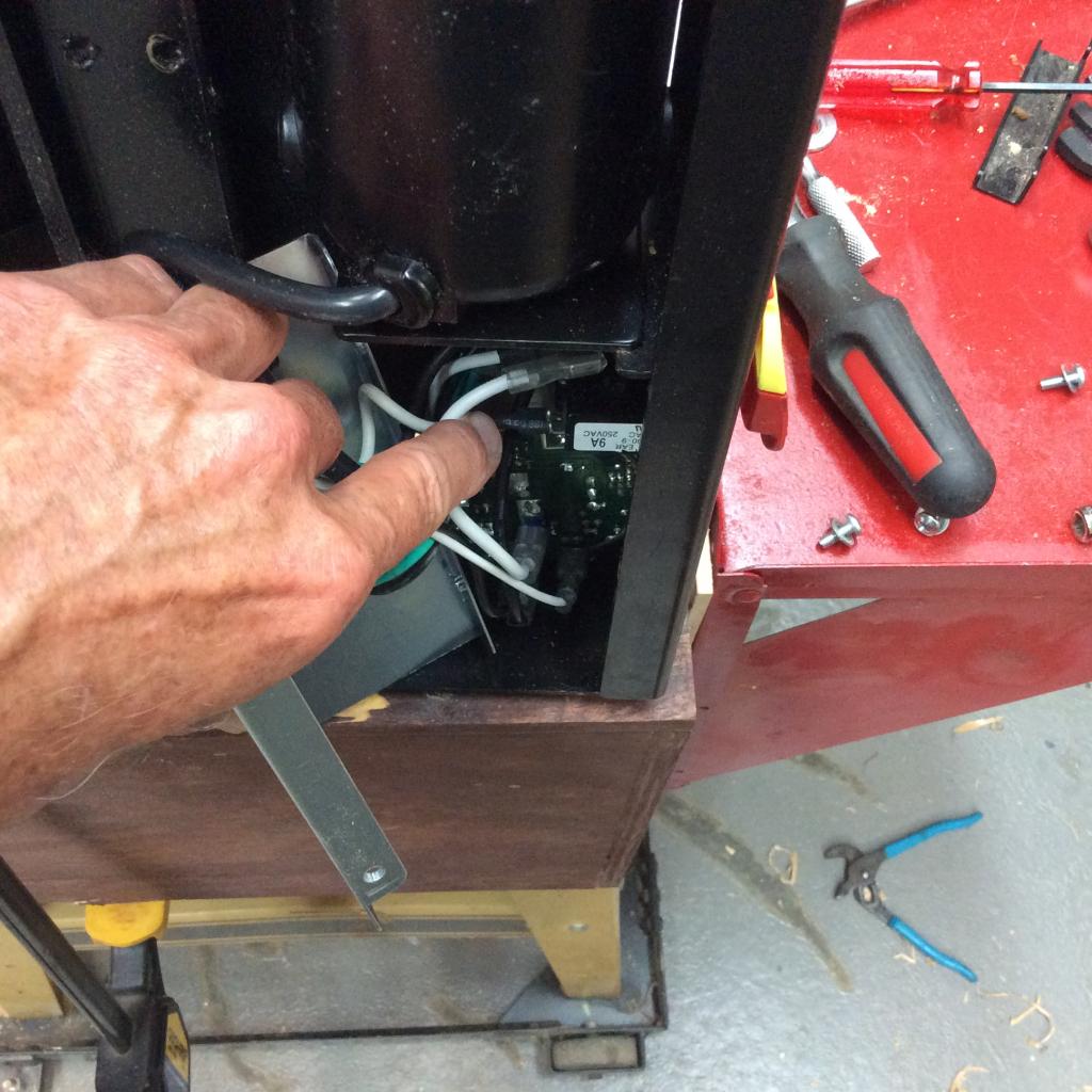

    Ken, welcome to the site. I'll try to sneak into the garage and take a picture of mine before I enter the chaos that is my house. If the dogs rat me out, then it will be later tonight. Stay tuned.
    Paul
      I definitely underestimated how complicated this would be. It seems like there's an access panel on the bottom of the variable speed controller, right? If that's how you got to it, it's going to be a couple of days because my sander is bolted to a cart which is behind a bunch of junk in the shop.
                Unfortunately, It is a lot of work to take apart the speed control unit for the belt. The circuit board on my machine checks out. As far as I can tell, everything is OK there. The issue I have is the pot switch. This is the part that attaches to the dial. the pot switch connects to the circuit board via two long wires wires. The pot switch is then attached to the top of the control box using a nut on the outside of unit.
