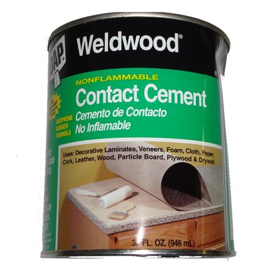

    I have been using the nonflammable Contact Cement for my not-so-heavy needs, like laminating the boot shelf doors, or an occasional ply/laminate for table tops.
    I see that HD has stopped carrying it in-store, and it must be because of the very bad reviews it has received from customers, who complain that this type of CC (the nonflammable is water-based) does not really stick. FWIW, it has worked admirably for me, without fail.
    Anyway - now that I want to sandwich a thin ply between two plastic laminates for making doors for existing cabinets, what are my choices if I don't want to wait a week for online delivery? I could get the regular Contact Cement, but it comes with such dire warnings (can catch fire! dangerous fumes!) that I am wondering if the other stuff like Liquid Nails and similar would do for my purposes.
    I loved the no-pressure-needed adhesion of the CC. With any other glue, I'll have to provide the clamping power.

        I tried one of the construction glue yesterday, and did not like it much : takes too long to squeeze out, spread out and keep pressure on. Has it's value for doing other work, but for my purposes, not all that easier than CC.
        I'll go back to CC - and just keep the garage door open while working!

              I've had good luck with water-based CC by using two coats on each surface.
              Never had any luck with just one coat. Pressure roller is a must, also.

                That must be the trick for me - I have found my applications of water-based CC have worked just fine. But probably because in abundance of caution, I have always used two coats on each surface. I guess I can confirm your point!
