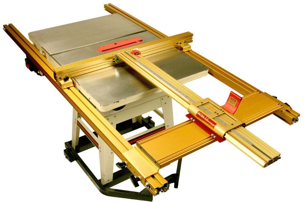

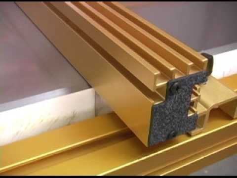

      There are 2 fence glides that ride on top of the rails and both have a tab that locks onto the rail. The back one has an allen screw attached to the tab and the screw is tightened up just enough so fence remains flat to the table but still allows the fence to slide left and right. The front one has a knob which you tighten completely after you engage the lock on the fence base.

      Originally posted by capncarl
      Jussi, I couple of questions.
      How does the Incra rip fence attach to the cross bar on the table saw? The Bessi clone had some angle iron and a handle. It's not obvious on the photo.
      Which powermatic do you have?
      capncarl
