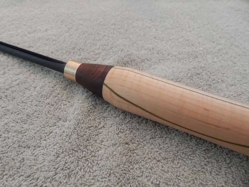

      This year I plan to try turning bowls. I bought a bowl gouge last year (unhandled -- I like to make tool handles!), and turned this handle for it. Maple with embedded green-colored veneer, with a walnut cap. The ferrule is a brass compression nut with the hex shaped removed during turning. Copper and brass are pretty easy to turn with HSS tools.
