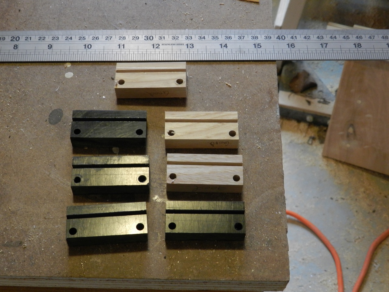

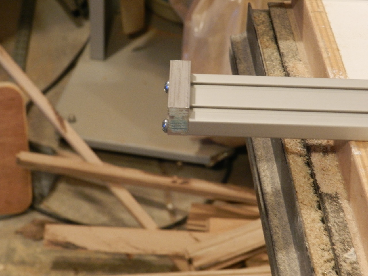

    The hard part, at least so far, is to make the little pieces that slide into the DeWalt tracks and screw to the 80/20. I wanted to try the plastic for it but the inventor of this setup used aluminum so I bought that too. To help with setup, I made some hickory pieces about 1/2 by 12 by 3/4 and 7/8 wide (two different pieces). I tried making it thicker than 1/2 but it wouldn't slide in freely.
    I found my thin kerf ripping blade (Freud 24 teeth) was about 1/64 thicker than the track material. I cut the slots in the little 1/2 thick blocks by raising the blade about 1/8 inch and setting the rip blade 1/4 inch away. I tried the cuts in the wooden blocks first. I adjusted a couple times before I was happy with the setup. That and tapping the holes in the 80/20 was as far as I got last Sunday afternoon. A 10/24 tap can be run directly into the hole in the 80/20 - you don't have to open them up with a drill bit.
    This morning I started figuring out exactly how wide I wanted the little blocks, how long they should be, and drilling the holes Took all morning but part of the reason was my drill press table wasn't fastened down. I am still setting up the new shop so that slows down working in it. I cut a piece of the hickory, took a stab at the width ripping it on the table saw and set up stops on the drill press and drilled the holes. I got it to narrow and the holes were not right. So I made a couple more blocks before I got it right. Then I ripped all the wood I had left and the plastic to width. I also ripped the aluminum on the table saw using the same Freud ripping blade. It needed a little filing to clean it up but the saw cut it fine - I went slow. The RAS did not cross cut it well, however. It wanted to climb cut. I cut the second piece with my Bosch jig saw.

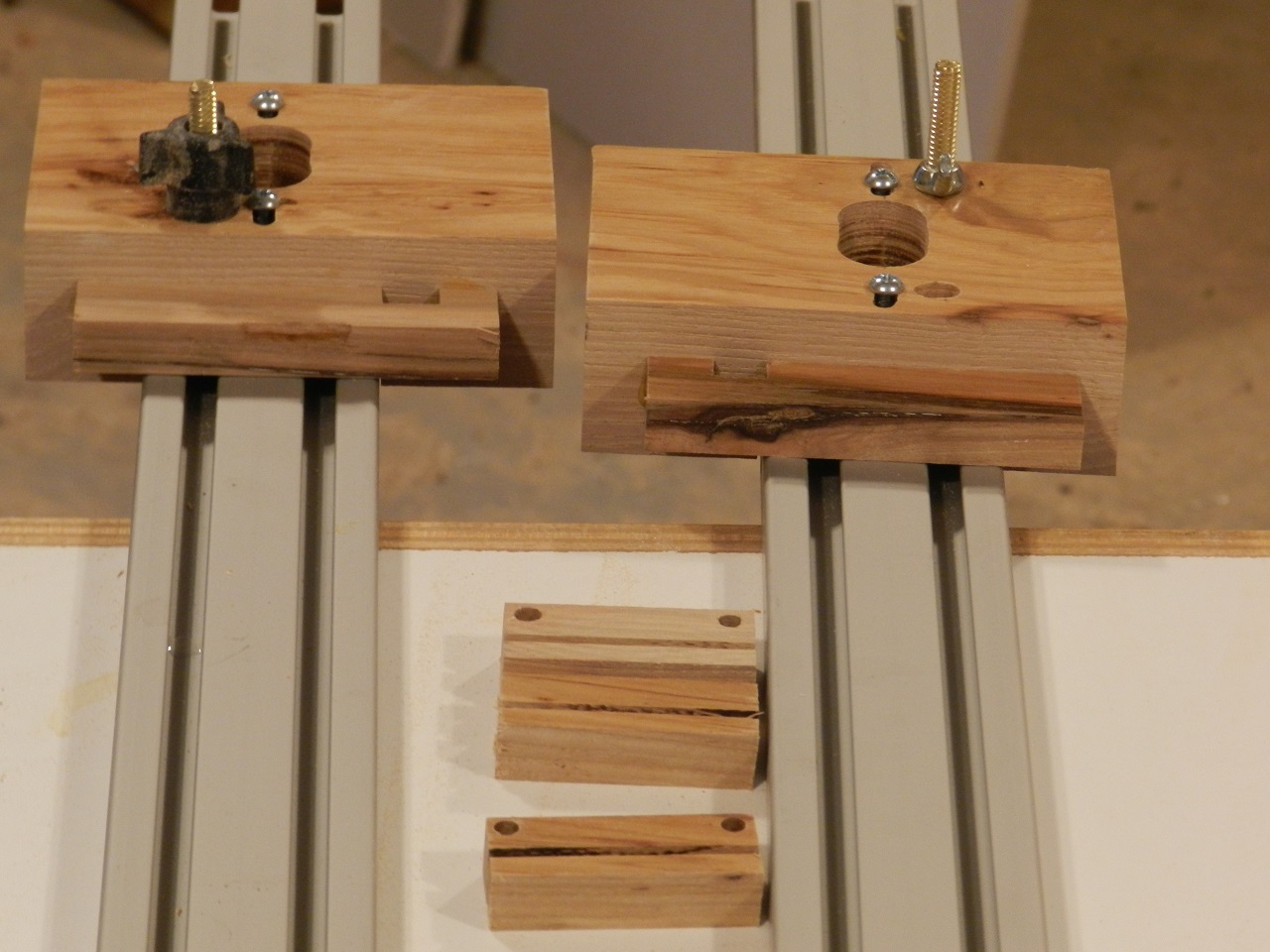

    I think hickory pieces would work. The ABS may be a little more durable. They don't slide as easily as the wood or aluminum, however. I put the aluminum on the 80/20. It slides well and should resist damage better than the others. But if I was starting again, I might just use Hickory.
    Before I did the work on the blocks, I glued up a piece for the stop blocks out of some hickory flooring scraps. I'm about to go cut them into the configuration of the stop blocks. It's cold here but the glue should still be set up enough.

        I think hard maple would work but I'm leery of cherry. It isn't as hard. Both maple and cherry like to split more than hickory and hickory is harder than either. I happened to have hickory flooring scraps so I used them. Hickory is also heavy, each 22 square foot box of flooring weighed 70 lbs.

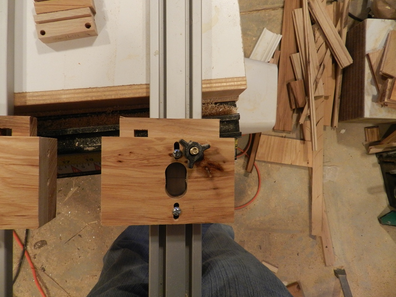

        I built the stop blocks this afternoon but my package from Rockler didn't show up. I ordered 5/16 cam clamps and need 1/4 so I will have an issue anyway. I tried 1/4 toilet bolts I had and they work fine with wing nuts. It doesn't take a lot of pressure to lock the stop blocks in place. The little mini clamps are also 5/16 but I think I can change them easily. No sure it will be that easy with the cam clamps. We'll see.
        I had trouble with the clear plastic cursor pieces. The OP used little nuts that you push in (at least that's what it looked like). I've never used them before but got some and gave it a try. I drilled it with regular twist bits and the plastic kept wanting to twist up the bit. I ruined two pieces that way. Then I tried forstener bits. A 3/8 was a bit oversize but OK to resess the big end and a 1/4 was about right for the piece you press the nut into. So the short message is drill a stepped hole with forstener bits and forget using twist bits.
        The only other difficulty I had was with getting the hole for the toilet bolt that holds the stop block in position in exactly the right spot. I eyeballed it, got it wrong, and then shifted the hole the wrong way. Finally I figured out what was going on and moved my fence on the drill press the right direction and drilled a hole at the other end. I don't know how to do this easily, making a spare stop block to experiment with would be one way. But if you don't get hung up on appearance, you have four locations you can drill on each stop block but you may have to live with a hole in the wrong place being visible. I think I can live with it but if it bugs me too much, I'll make another.
        This isn't a terribly hard build but there are a number of things where you don't have much flexibility. The holes for the bolts on the stop blocks, the grooves in the block at the end of the 80/20, the holes in the block at the end of the 80/20, and the holes for adjusting the cursors versus the nut locations. You can allow a little extra clearance and solve some of this but I tried talking more time and making scrap pieces for most of these situations.

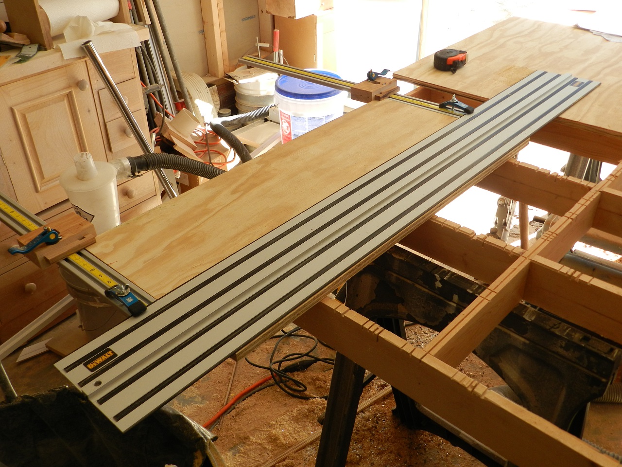

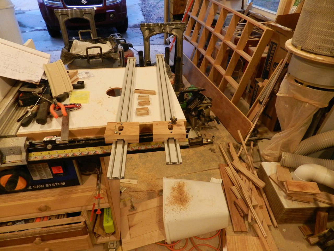

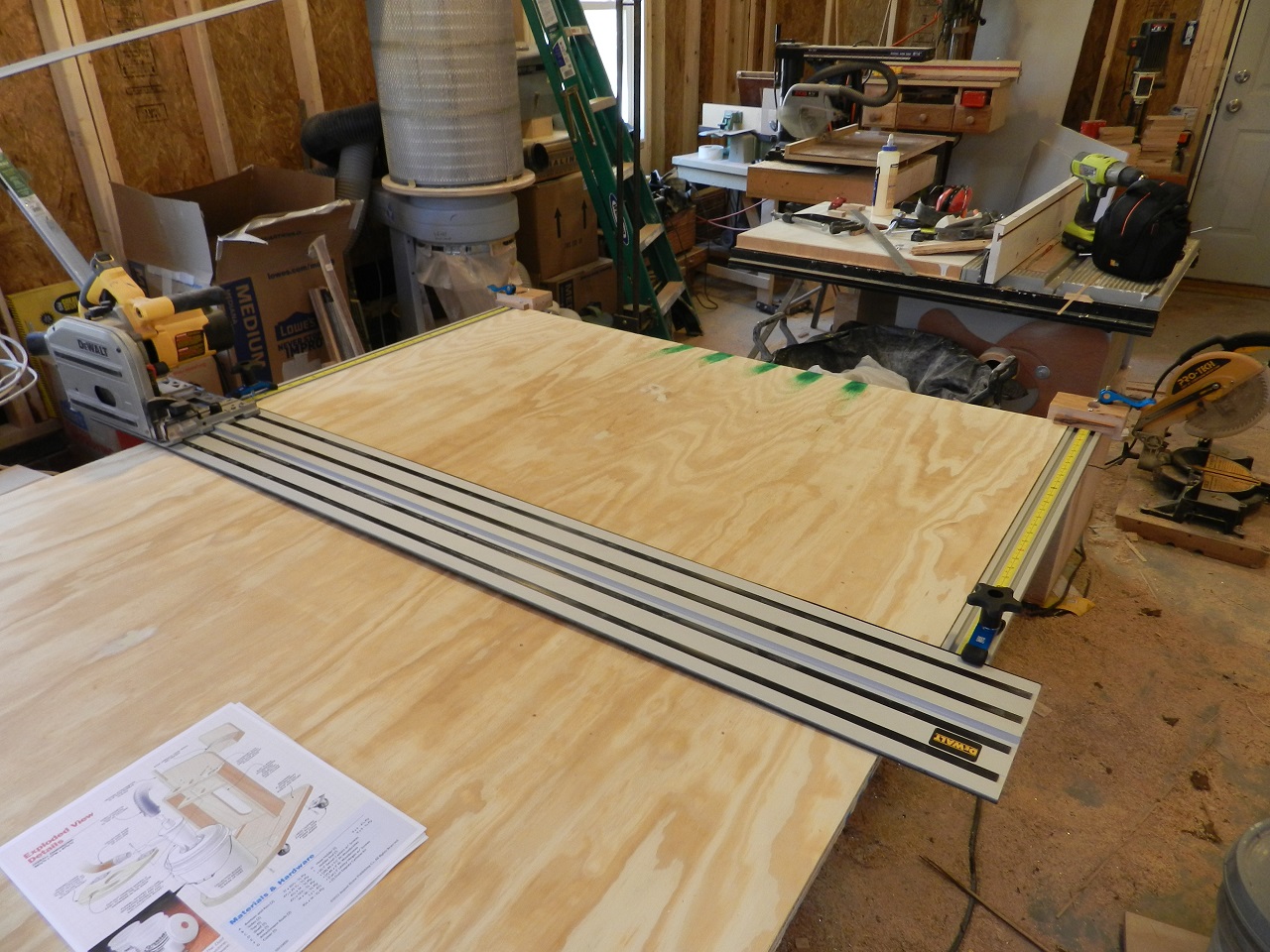

            Ok, some pictures of the finished guides including first usage. The first photo shows the completed guides on a coffee table where I calibrated the scales. I used the steel ruler in the picture to set the stop 12 inches from the edge of the track. Then I put pencil marks on the 80/20 so I could remove the stop and put the stick on ruler on. Then I put he stop back and moved the cursor to get it precisely aligned. That worked very well. I had to trim the plastic a little during this calibration but didn't have to remake the cursor pieces.

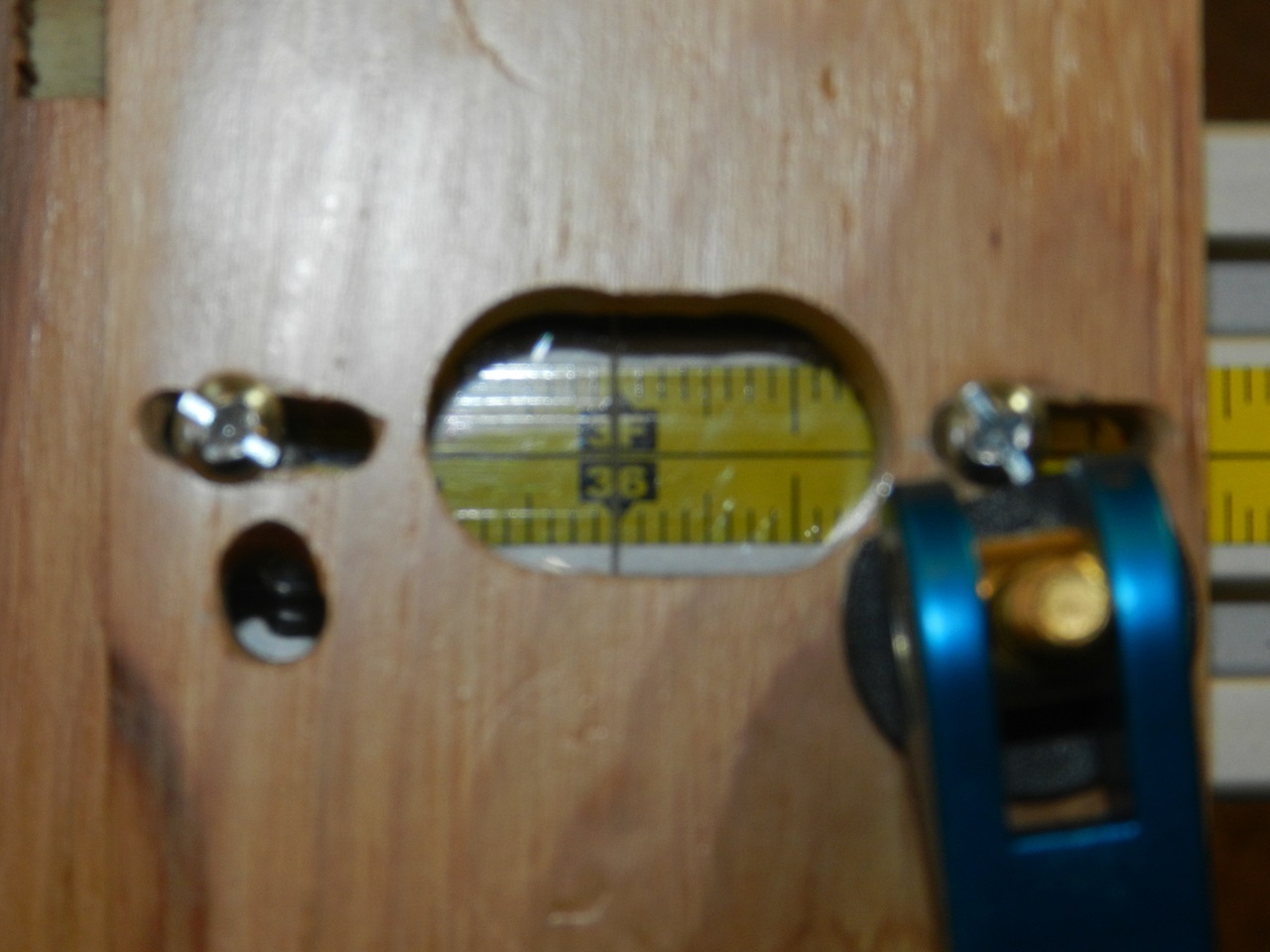

            The next picture shows the cursor. It is easy to read despite the thickness of the stop block. I think it's fine at 3/4 inch but I also think it could have been 1/2 inch. That picture also shows an extra hole for the clamping bolt for the cam clamp. It wasn't in the right spot. Doesn't bug me enough to make another stop. I should have made the cursor plastic pieces a little narrower. They are 3/4 wide and 5/8 would be better to keep them out of the way of these bolts for the clamp. A cam clamp looks nice but a simpler knob would work fine, perhaps better.
            The last couple pictures show the guide in use. I am making Woodsmith's shop vacumn/dust deputy cart this weekend. The first cut was at 36 inches. Easily within the capacity of this guide (but outside the capacity of the Festool $250 guide). I didn't notice it at first but the 1 1/2 inch tall knobs I have on the clamps holding the guides to the track were too high and obstructed the plunge action of the saw. That might have contributed to me being off 1/16 inch at one end on that first cut. On this project, that wasn't unrecoverable. I noticed what was happening and switched to wing nuts and had no further problems. Remaining cuts were within 1/64 inch, same as with a table saw. I did not mark the wood, I just set the stops and cut.
            The capacity of these guides, as is, is from about 11 inches to over 36 inches. I will probably add little 1/2 inch square by 12 inch extensions to the sides of the stop so I can do narrower rips. They will screw into brass inserts in the side of the existing stops so they are easily removable. The guides are very usable as-is, they just won't do narrow rips.
