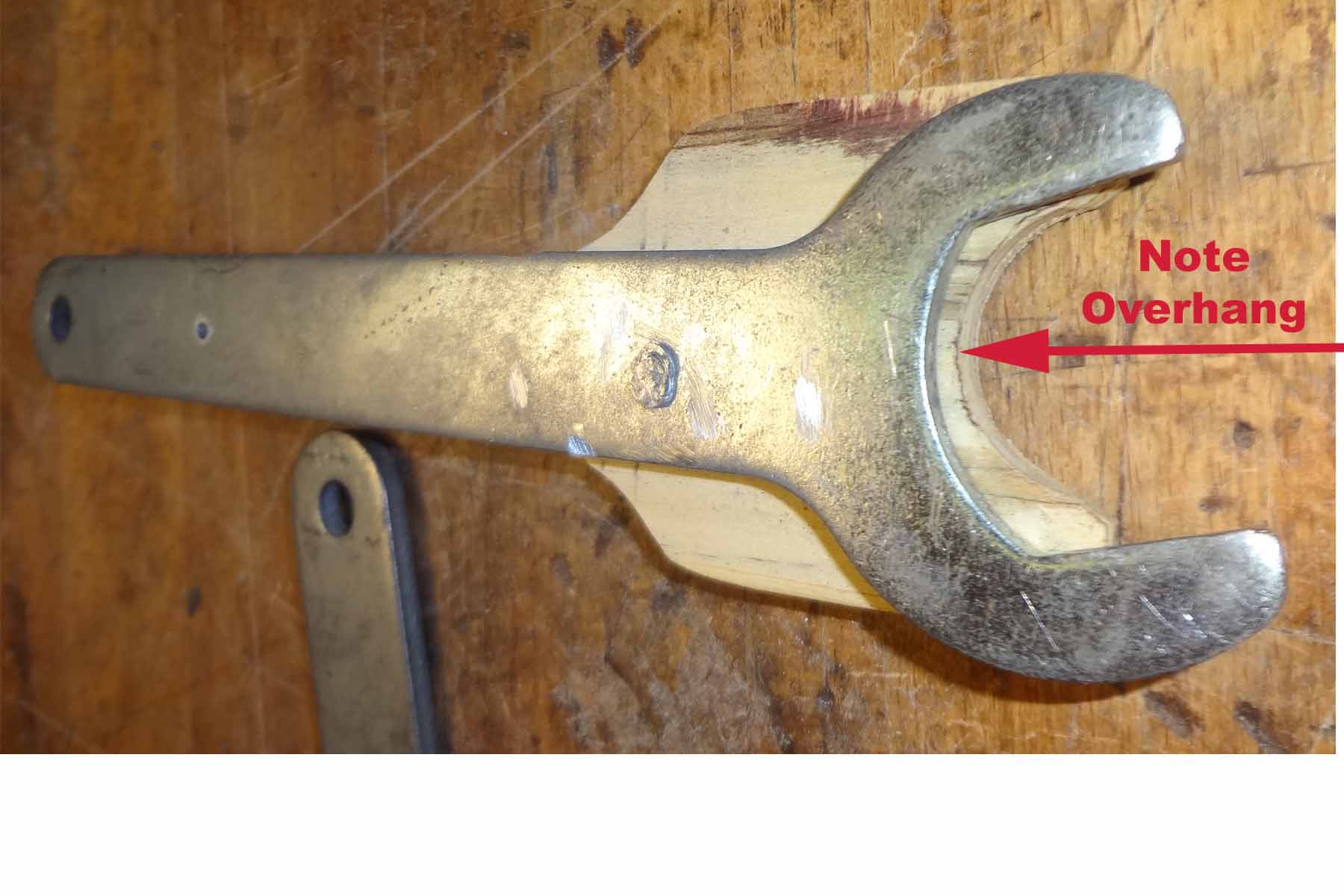

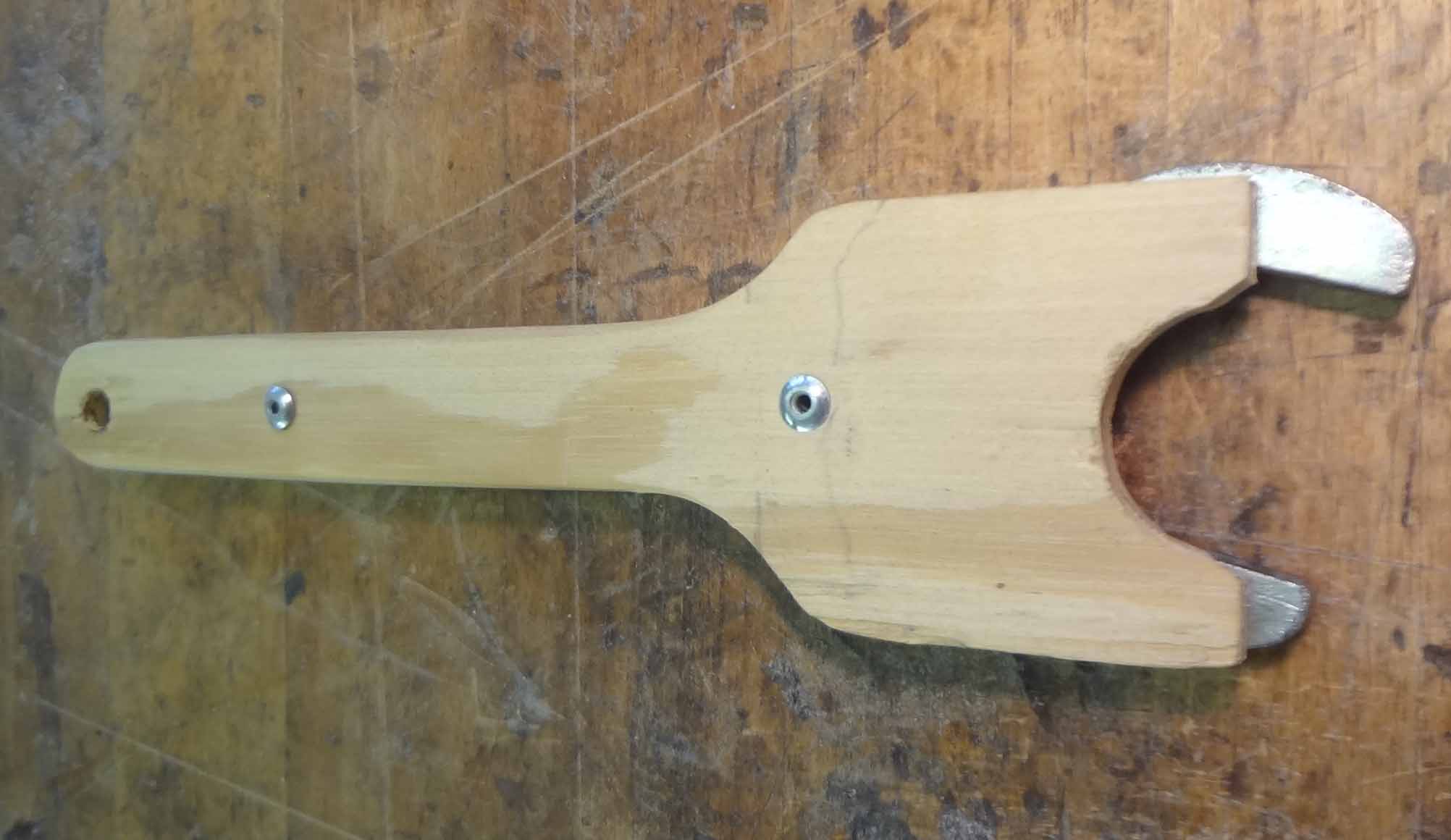

    I have an older porter cable router and after eight years I've finally had it with messing with those two dang wrenches to change a bit. Here's what I did today. Hopefully the pictures will help tell the story.
    1. I cut a piece of 1/4" ply to fit in the slot in the motor's body.
    2. I pop riveted onto one of the wrenches. NOTE! The ply extends below the wrench in order to slide behind the nut.

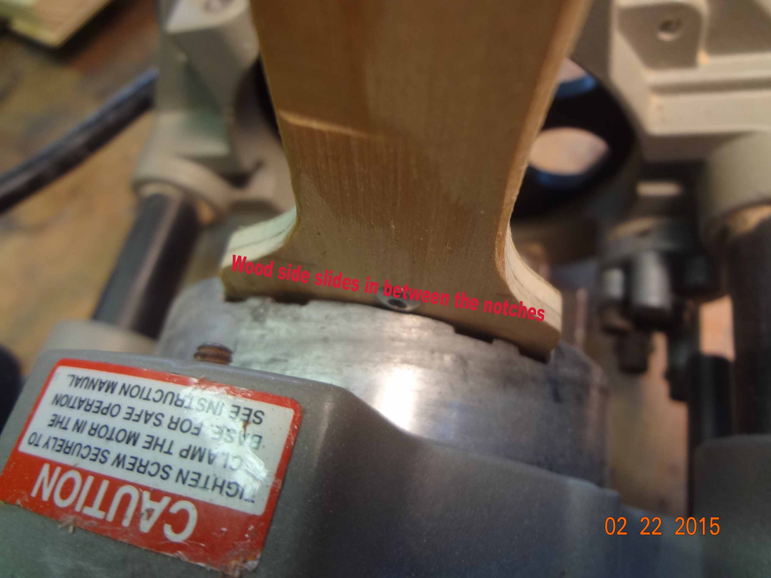

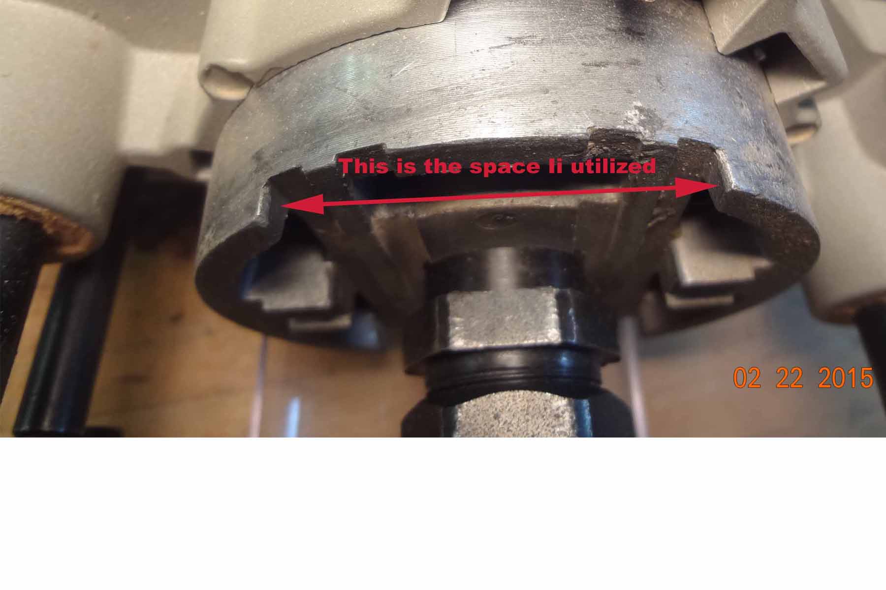

    3. Then you slide the ply/wrench combo in between the slot noted earlier.

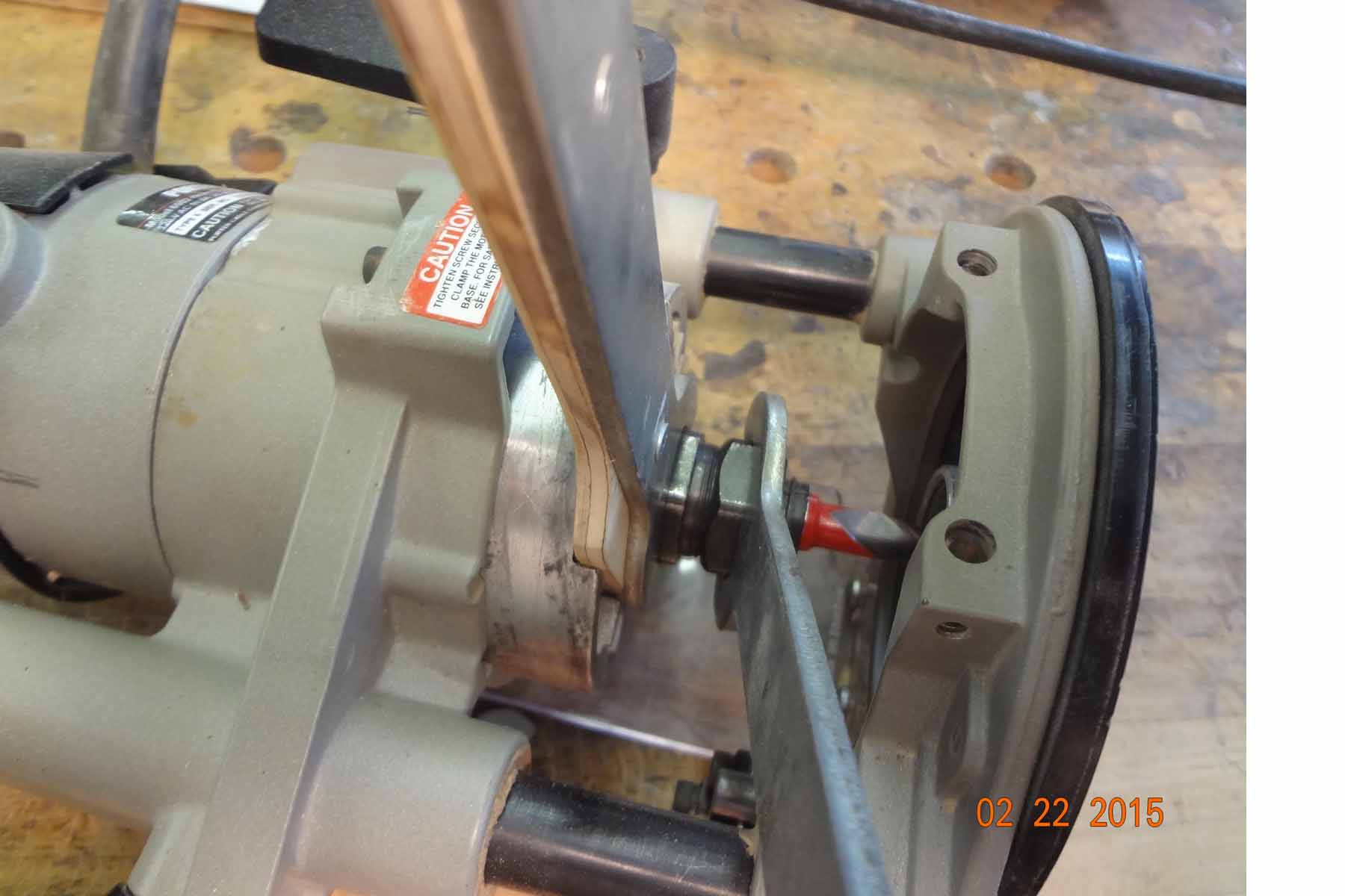

    4. In the last picture, with the adapted wrench in place and the second wrench on the other nut you really don't need to use two hands.

    You lost me, what is the plywood for? I've made a number of wrenches for routers and grinders using flat cold rolled steel from the hobby sections of HD, Tractor Supply and Lowes. Grinder with a razor disk and lots of filing makes a fine wrench!

        There is a gap between the top nut and the body of the router into which the wrench always falls. The plywood will take up that space. In other words, the wrench isn't thick enough. Sorry Sweet Willy, didn't mean to step on your turf.

          I totally understand now. Wrench not thick enough.

            I think he also made it close to the dimension of a "slot" in the base so that it will not rotate when changing bits. Therefore, he doesn't have to hold it.
