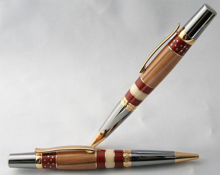

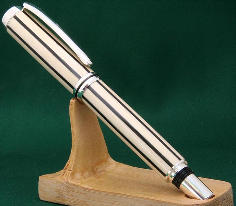

          As to pen turning precision segments, see below. I think larger turnings, segments and frames would magnify imprecise cuts even more that what I mention below.
          On the top pen (2007), I made the blank on my home made table saw (6 1/2 inch saw turned upside down in a home made table) and sled and it came out PERFECT. After trying to duplicate it, I went through (made) 6 home made blanks after that and still did not get a perfect blank. I gave up after that. I did not make the other blanks into pens because one end would be off by enough that I could see it even though others might not.
          On this pen (2008-'09?), I was able to "mass produce" after the first two by making many segments at a time. Glass Smooth cuts were necessary to prevent glue line visibility between the wood segments and brass ring separators.
          Believe me, if a single segment is off by 1/100 inch in whole or part, it is obvious. I have been to numerous shows and shops that featured some fine craftsmen. Some turners make perfect joints, some don't. Those that command the high dollars don't. I am not interested in selling, just something without the distractions of odd sized glue lines. I must admit that the time to assemble a single pen even in mass producing is about 8 hours.
