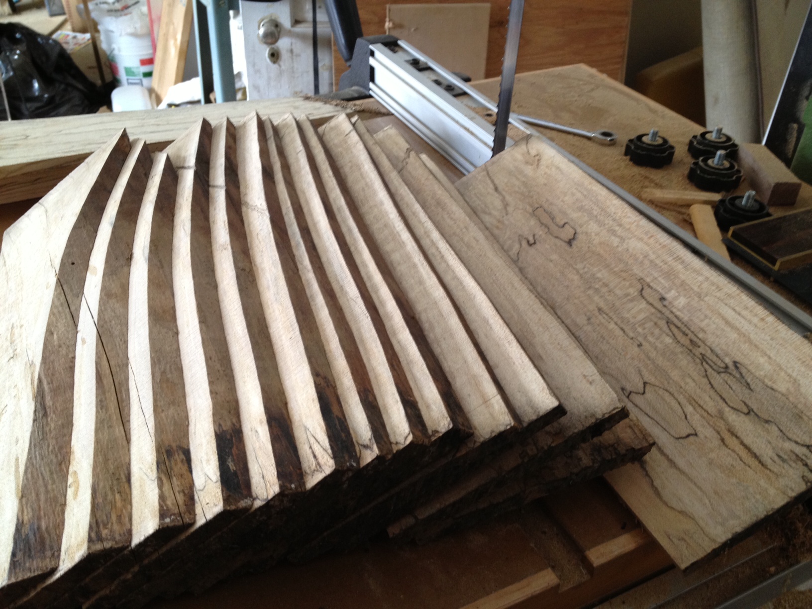

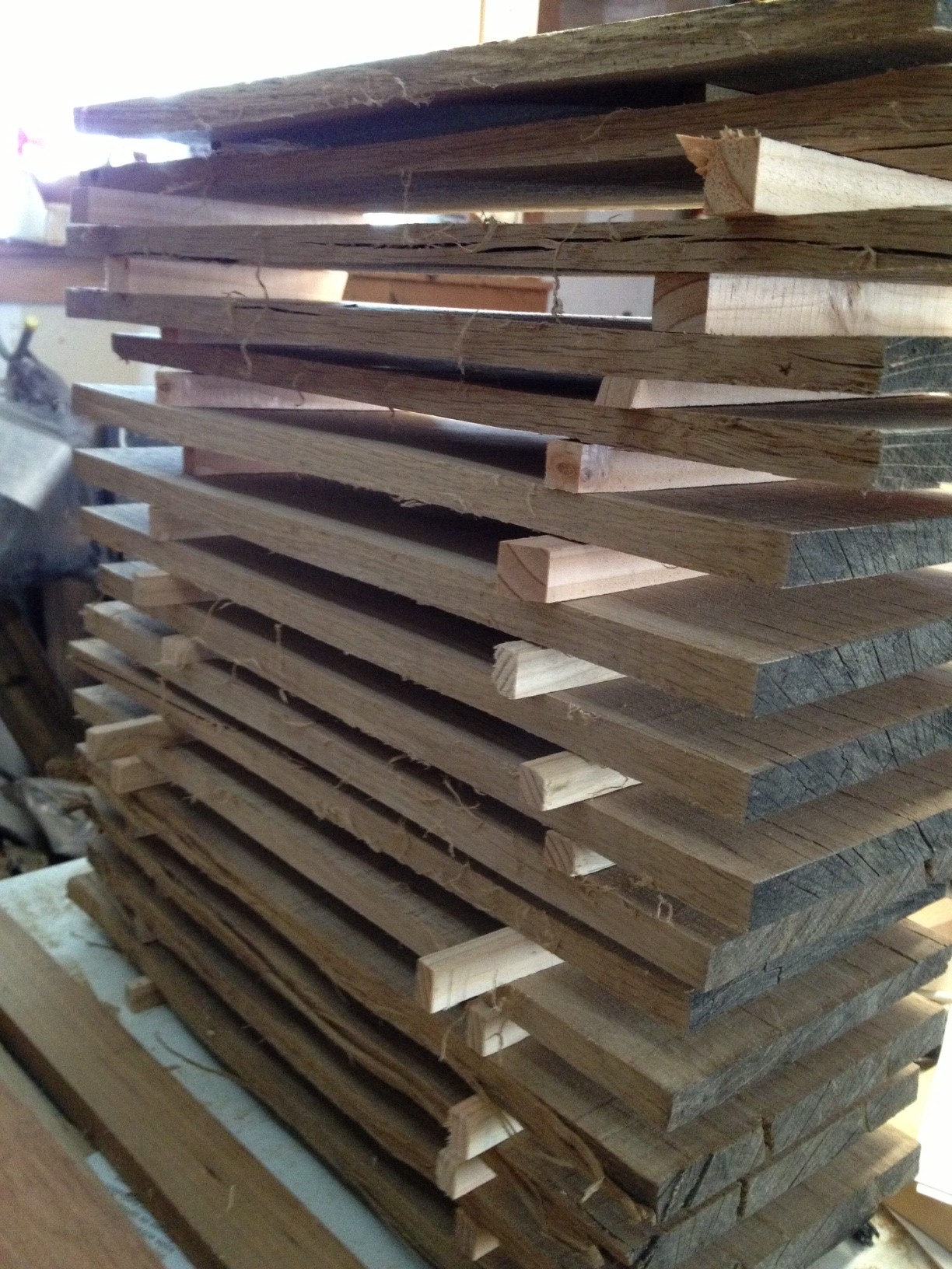

                wood slicer vs w oak
                Here is the wood slicer on my harbor freight band saw setup as in the video. Cutting with ease, good finish, no blade drift.

                    Really I wanted to share on the usefulness of that video. The band saw for me has been a hit or miss setup machine for almost 10 years. Sometimes, with some blades I'd get great results, other times I wouldn't go near the thing for months at a time. Defeated by the subtleties of setting up a band saw correctly and consistently.
                    What those pictures really say is "I should have a pellet stove".. Those were chunks destined for the wood stove that I simply could not bring myself to burn despite the ridiculous winter we've had here in NY.
                    The white oak is for a shoe shine box I am making for myself. The spalted maple was in queue in front of the band saw to get sliced up. Nothing planned for it yet..
