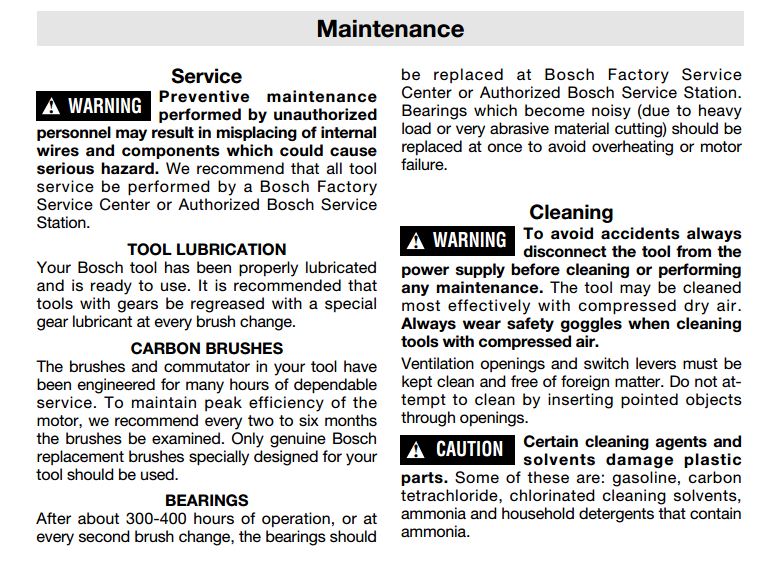

    I know where my manual is but I found the manual on-line (Amazon has it on the product page) with less effort. It has sealed bearings I presume, no lubrication necessary, but replace every 2 brush changes... 300-400 hours of operation. I wonder how I can figure that out...
    lets say Fifty projects, average less than ten minutes each... less than Ten hours running time. I guess i have a long way to go.

      Loring, are you saying that you need to replace the bearings with installation of the third set of brushes OR circa 400 hours - or could the need for a third set of brushes be the indicator that 400 hours of operation have been reached?
        • 22109
        That's just what the manual says. I presume that the point is that they think your set of brushes will last 150-200 hours. Or that's what I read into it.
        I guess they rate the bearings at ~400 hours. I'm sure there's a dependency on speed and temperature and side load as well. I would presume higher speeds, higher temperatures and larger loads will accelerate wear.
        So it's all approximate. YMMV as they say.
