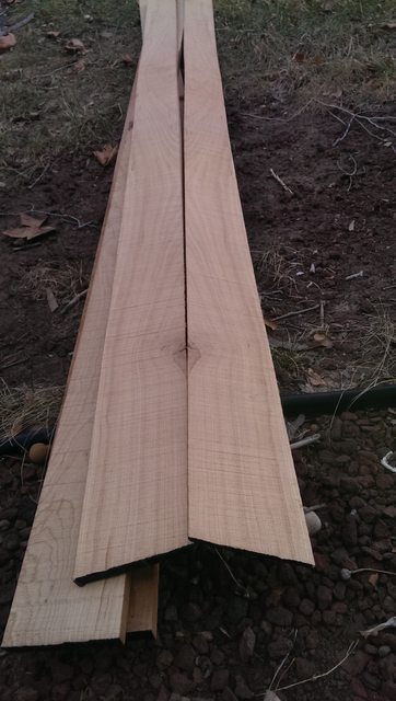

          We got through about 24' of cherry before the lower guide bearing seized up.. The upper wasn't log for this world either.. I don't think either one had a drop of grease in them.

            Yay, I see the pics now. Nicely done. Where did you get the bearings?
