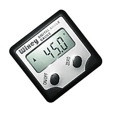

          Another very useful digital tool is a tilt box. I have that Tilt Box II, and I had a early version Wixey. The Wixey finally quit working. The batteries wouldn't last at all with the Wixy either. I like the Tilt Box II a lot better, especially the built in level function.

                  tilt box (ala Wixey, others) is somewhat similar in that is displays digital angles, but it s also different and complementary so you might consider getting one of those also.
                  Unlike a fixed arm protractor device, it has a pendulum for live measurement of vertical angles. Its really useful for putting on a blade and cranking to a precise angle, or checking a jointer fence for perpendicular to the table, or setting a drill press/bandsaw table to angles - you can watch the angle as you make the adjustment, live. It has a zero so you can set the reference surface as zero and then magnetic bottom so you can attach it to a blade, fence, etc.
