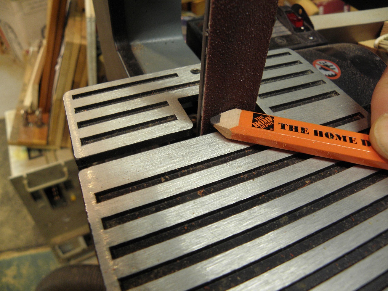

      Hold the pencil on the sander table with the sanding surface moving downwards into the table, its well supported and nothings flying anywhere.

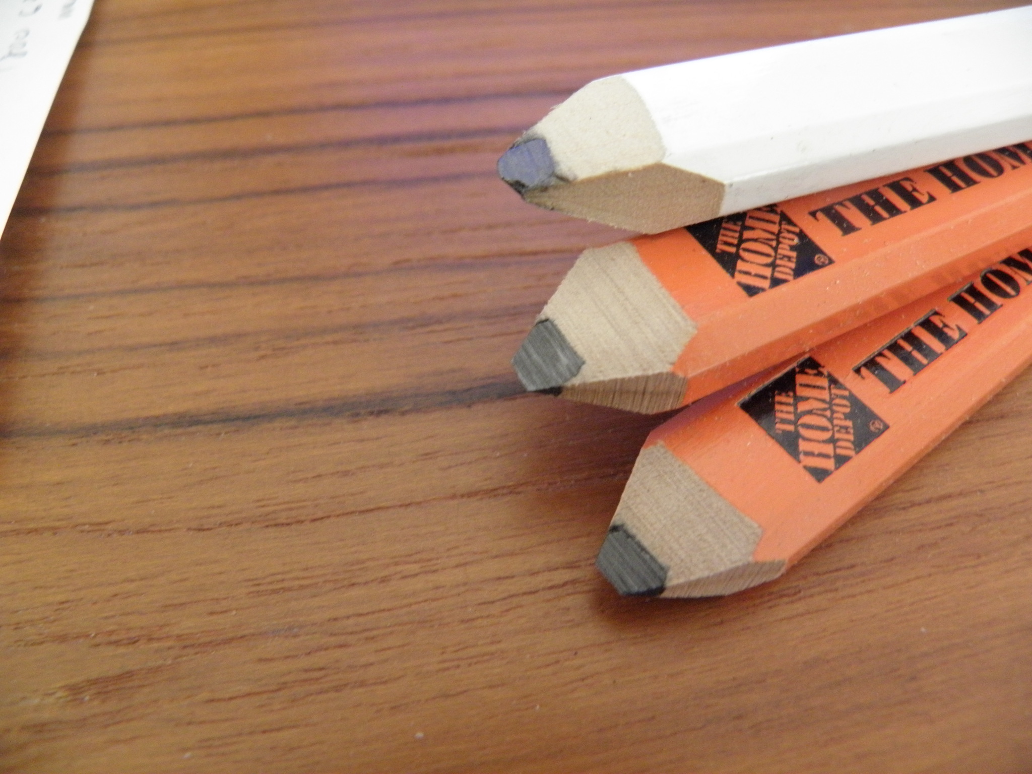

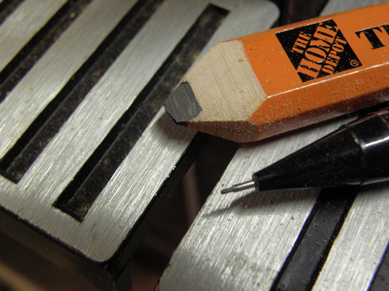

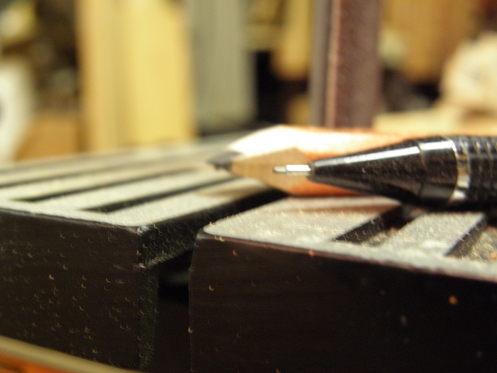

      Attached as thumbnails - how to point them. comparison of sharpness to a .5mm pencil. Because its long in one dimension and narrow int he other, it doesn't go dull as fast.
      THis is the kind of point the Hanson sharpener they sell at the box hardware stores puts on the carpenters pencils, the lead is not pointed at all.
