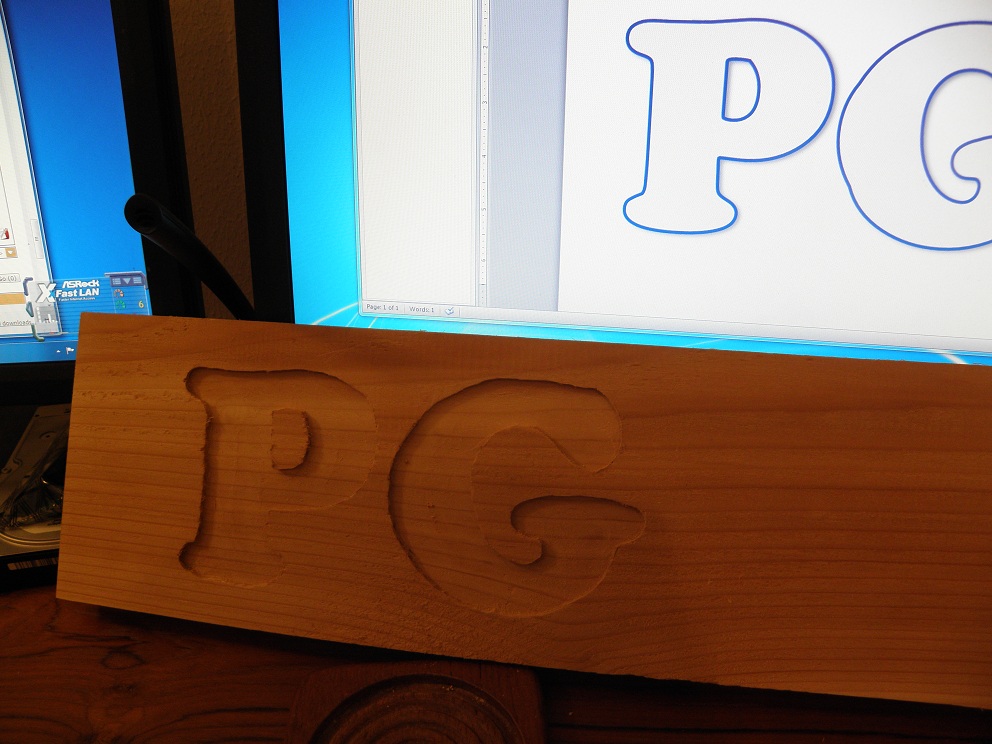

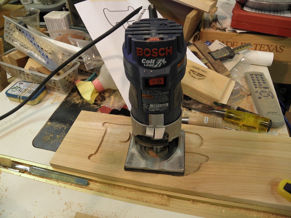

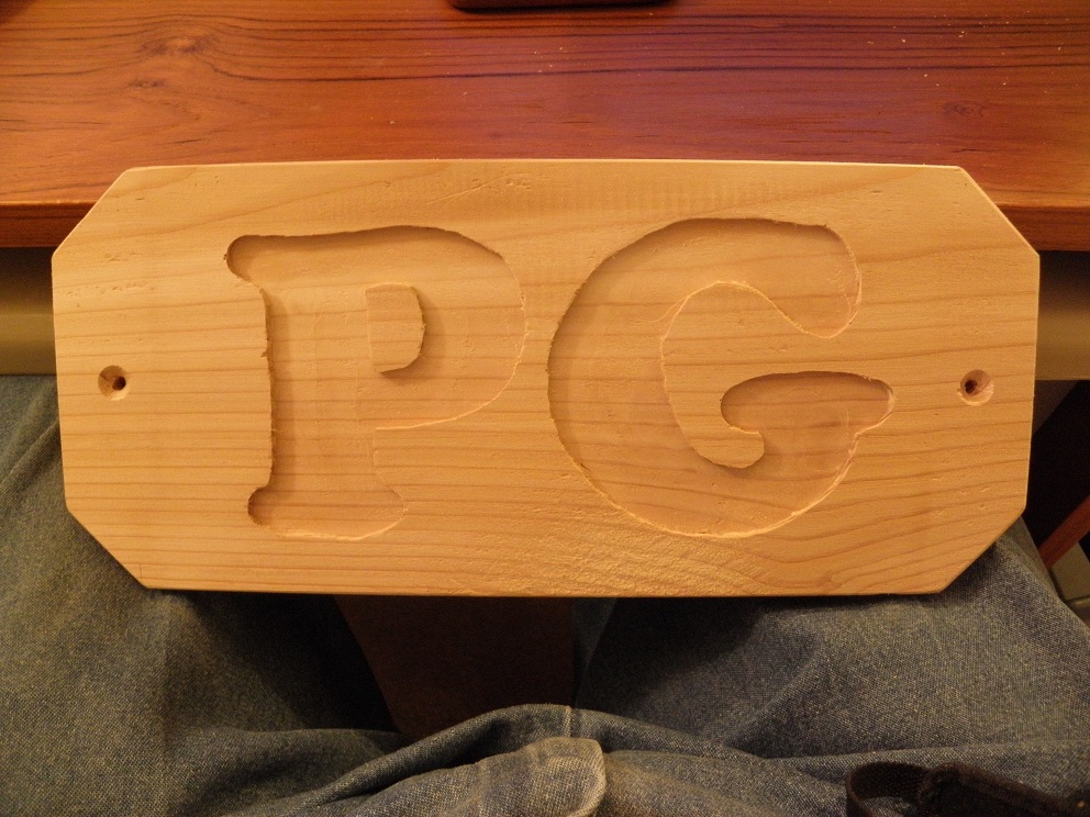

    my sister gave me a reconditioned Bosch VS Colt for xmas. Its the palm router and joins my other routers (Bosch 1617, Bosch 1617EVS, a old Craftsman, a Dewalt 621) so I'm a 5-router guy now?
    tried it out tonight, pretty sweet. I tried some sign making. Used the MS Word with 450pt font, printed, transferred to (cedar) wood, then free-handed.

      BTW...nice work for free hand.
        • 22106
        thanks c'man.

            Is a plunge base all that necessary for a palm router? I just tilt the plunge-cutting bits in, works fine.
            ANy words of wisdom as to when its useful? I have a plunge base for my 1617's but seldom use it.

              Nice job on the letters too.

                Words of wisdom...me?? I don't know how wisdomy they will be, but I can relate some of my experiences. Some time in the low upper third of the last century, there weren't any plunge bases, soft start, variable speed, "electronic" (as advertised) routers. What was available were single speed...go at 'em routers.
                One had to learn how to fiddle with feed rates and depth passes for large bits. As for the palm type (I call them trim) routers, they had more than their place in woodworking and cabinetmaking. When I used to do laminate kitchens, I would have to hold an eared 1½ hp router in one hand pretty much all day long trimming doors, shelves, and boxes. The trim router became a staple for laminate work as it could be a fairly comfortable one handed router.
                But still after hours and hours of trimming, my hands would go numb, and I wouldn't feel it in my hand, and at times couldn't let go. But, the big picture was, that for control, they just couldn't be beat. I suggested a plunge base for you, as I have the impression that you dig accessories in general. With no plunge base, tipping in was the way to go. Have a good straightedge, and position the base to the straightedge consistently. The location of the base to straightedge could be visually maintained by other optical aids, such as the tightening wing nut on the base. Using this positioning located the bit to the same distance from the edge of the base for the entire pass. Or, a mark could be made on the base for location purposes.
                I have noticed that not all bases are concentric to the bit, so to maintain the same pass distance this was necessary. Trim routers, when used for inlay work could benefit from a plunge base on a very thin theory that if tipped in, the bit may divot the depth of cut at the tip in due to the rotation axis. When used as a general clean out for the field of an inlay, if care is taken, it's not usually a problem.
                Generally though, I really like trim routers. They can do more than we give them credit for. I do light profiling with them, especially when it can be done one handed. Over the years, I favored the PC 309 since they came out, and bought many of them. I still have several that are still in good condition. At worst, maybe brushes (no big deal). That Bosch you got is a great little router that you'll enjoy using.
