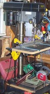

          I've got the 38142, which is the benchtop version of the floor standing 38144 you linked. I've been surprisingly happy with it....it's smooth, quiet, powerful, has reasonable quill travel, very low vibration or runout, is heavy, stable, and was $144 on sale.
