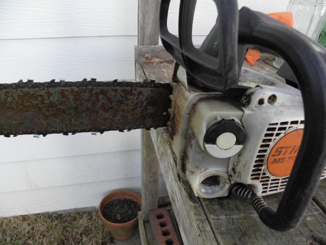

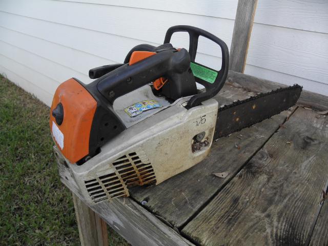

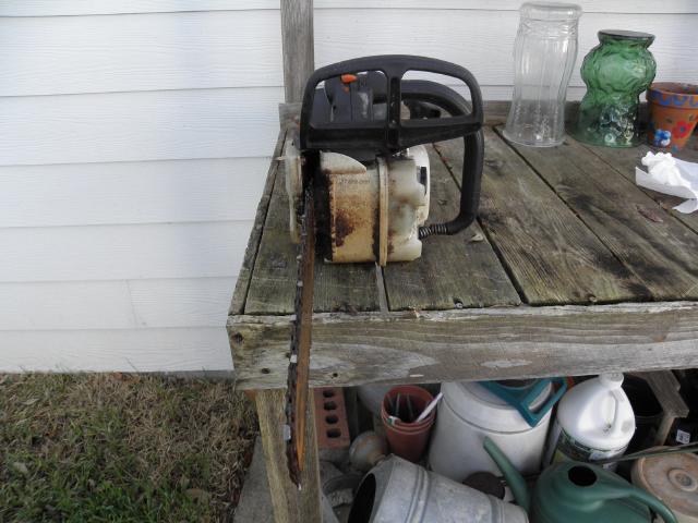

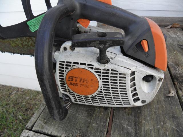

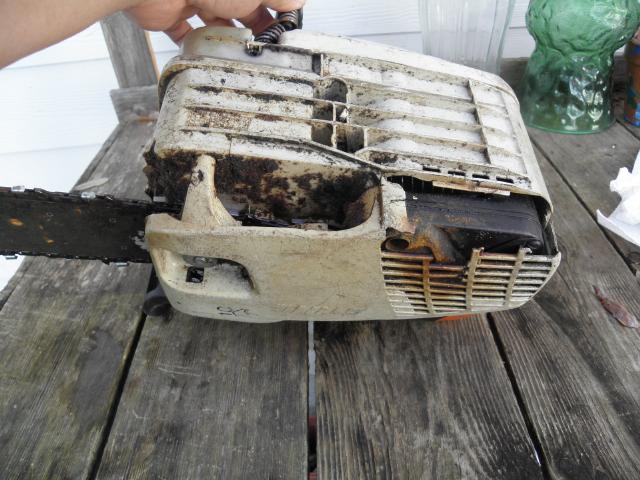

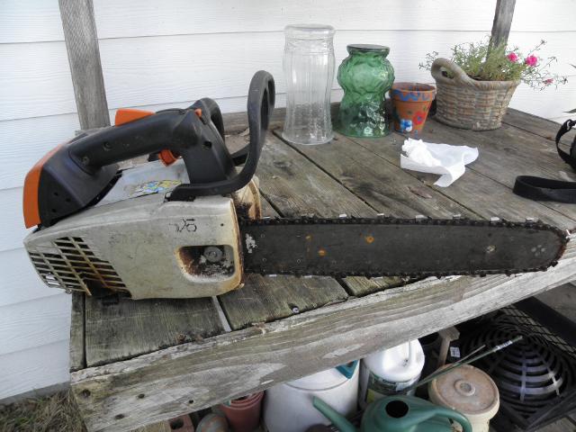

    Well been three weeks now and the CS is still on the bench. So I look at it again -it had a hard life, I'd venture to say its fallen out of several tall trees.
    I know it was running fine because I saw him using it but after 3 weeks in the rain it's a little worse for ear (not much tho). The thing had two tanks, one for gas-oil mix and another for probably chain oil I think. THe chain oil tank is missing the cap and the tank was nearly empty so to keep it from leaking my wife put it on the bench tank opening up so now its got a little oil and a lot of water in it. THe chain bar is all rusty.

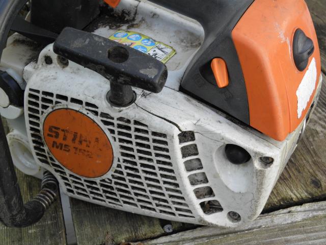

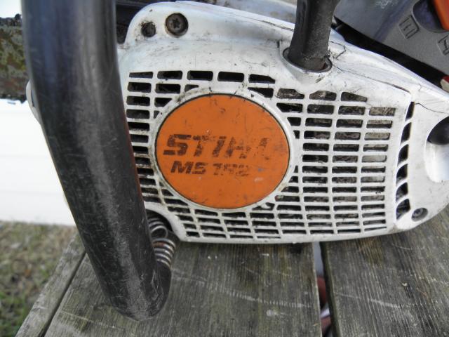

    The model is Stihl MS182 which I can't find reference to being sold, or parts for or a manual anywhere on the web. I think it deserves at least an cap for the tank that's missing a cap (chain oil?) Length of the chain bar is 13"
    I'm wondering what to do if he doesn't come for it (maybe that tells me something in and of itself)
    OK the pictures are below - tell me your thoughts:
    Junk? Disaster? just toss it
    Usable, fix it up a bit
    Are the top tank for 2-cycle gas-oil what ratio?
    is the bottom tank for chain oil?

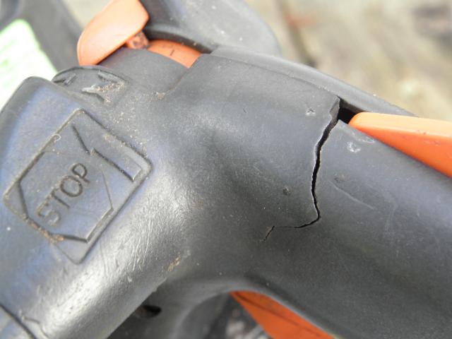

    are all those cracks/missing pieces in the case safe?
    whats the knob for on the back end of the saw in center of the orange cover?

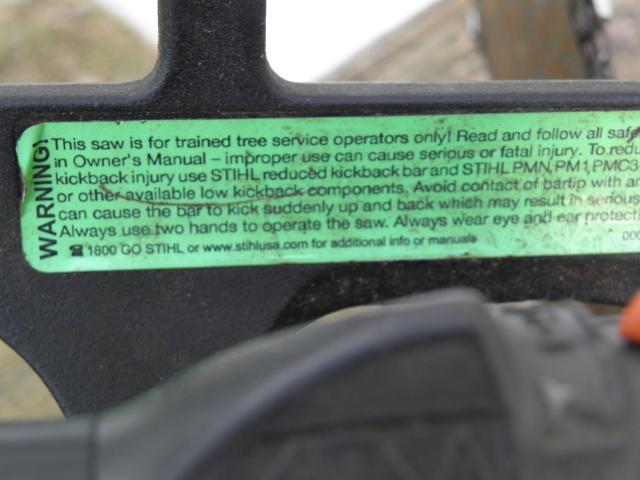

    The green label says for "Trained Tree Service OPerators Only" is that a normal warning or is this not suited to any other use or especially dangerous???
    why is this model not listed anywhere?

    It's a tree service saw, not sold to the general public.
    I would go down to the local friendly Stihl dealer and have him get what you need.
    If you want, since I will be going to our local dealer tomorrow I could check on parts for you.

      what makes a tree service saw special?
      ask him how much is the lower cap (looks like it may be different from the upper cap in keying so they can't be reversed)

        Professional saws don't really limit the kickback like a home owner or rancher saw so are much more prone to kickback which can hurt you badly.
        Also I would venture to say that the motor is probably in the 1.5 to 1.7 HP range and with the 12-16" bar it will scream while cutting in it's range.
        The last part of the MS number is probably "T" as in MS-182-T denoting a top handle.
        This isn't a standard rear handle saw that's easy to control from the back. The top handle will let it kickback more than most homeowner saws.
        OSHA doesn't like these saws for private parties, LOL.

                The saw look to be fairly current so the fuel mixture is probably 50-1 like most Stihl equipment. I have found the best way is a one gallon container and buy to small packs of Stihl 2 stoke oil. One bottle pre-measured for one gallon of fuel. Stihl recommends 89 octane. Yep, bottom plug is bar oil. That basically is a limbing saw which is what the guy was using it for.

                  Thanks DAL. I was thinking that chainsaws are supposed to be 2-handed devices for safety but the way these tree guys use them is to sling them around one-handed by the top trigger handle only. since they are hanging on for dear life with the other hand.
                  I wondered if these were made for one-handed acrobatic tree users at some cost of safety which is why its labeled for Tree service use only and its not generally available.

                        BTW, how long is the bar? It looks like a 14" from here but could be a 16". There should be a stamp back toward the power head that gives a number.
                        I'll see if I have a correct chain for it.
