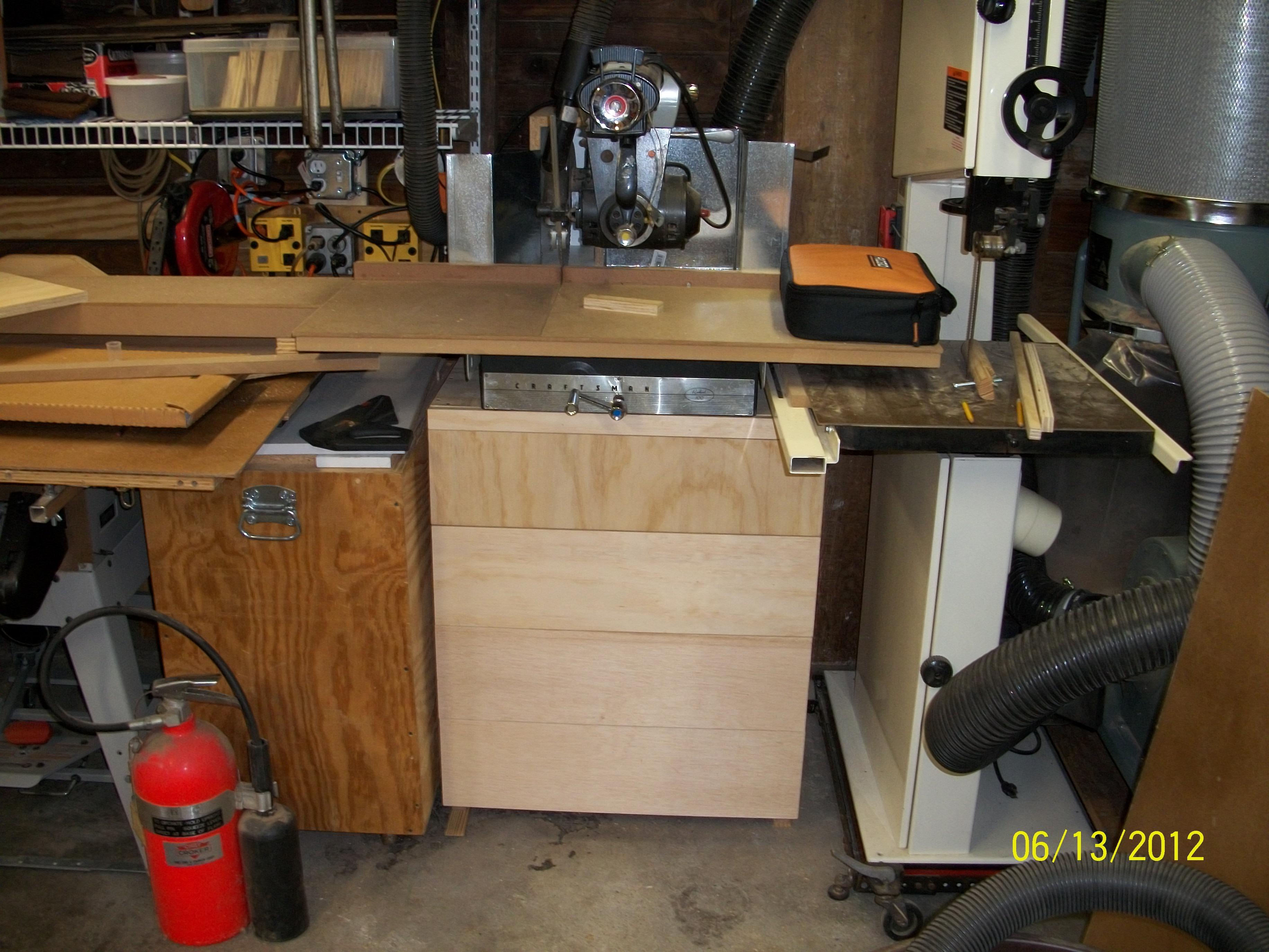

      this one was a cast of from a neighbor with an arm that wouldn't rotate 7 years ago. $60 in parts and it works perfectly and, with an adapted retrofit table kit (free), will crosscut 15+". i wouldn't be without it. but stick with a unit that is CI only. later c-man units with bolt together column supports did not enjoy a good reputation for maintaining their settings. just keep your hands clear of th eblade as you pull it towards you.
