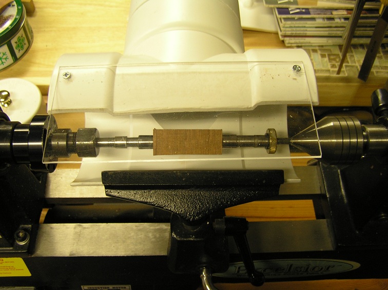

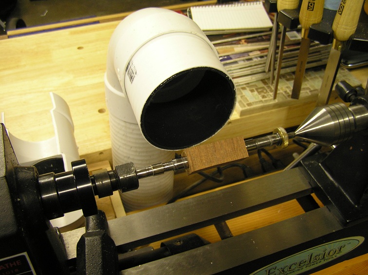

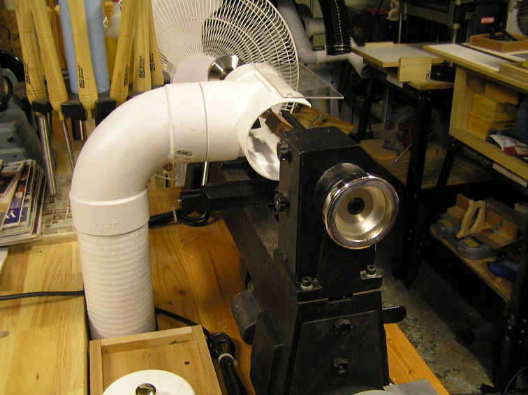

            Since my turning right now is primarily pens, this is exactly what I have done as well, and cut enough off the upper part of the "C" so I could attach some clear lexan to provide the benefit of a shield I could see through. In my set up, the "C" completely surrounds the pen blank, and the throat of the T is then only ~2.5in away from the blank. The bottom of the T is fitted with a short piece of drain pipe to act as a nipple, which I can slide into an elbow that sits atop a riser to which I connect my 4in DC line. I made it removable so that I could exchange the T for a short segment of pipe during sanding operations, as the T prohibits good access to the blank for sanding. I also tried endcaps on the T, and found that the airflow is good enough I don't need them.
              Added some pictures of what I described above. First two show the T in position, third is the "sanding" config.
