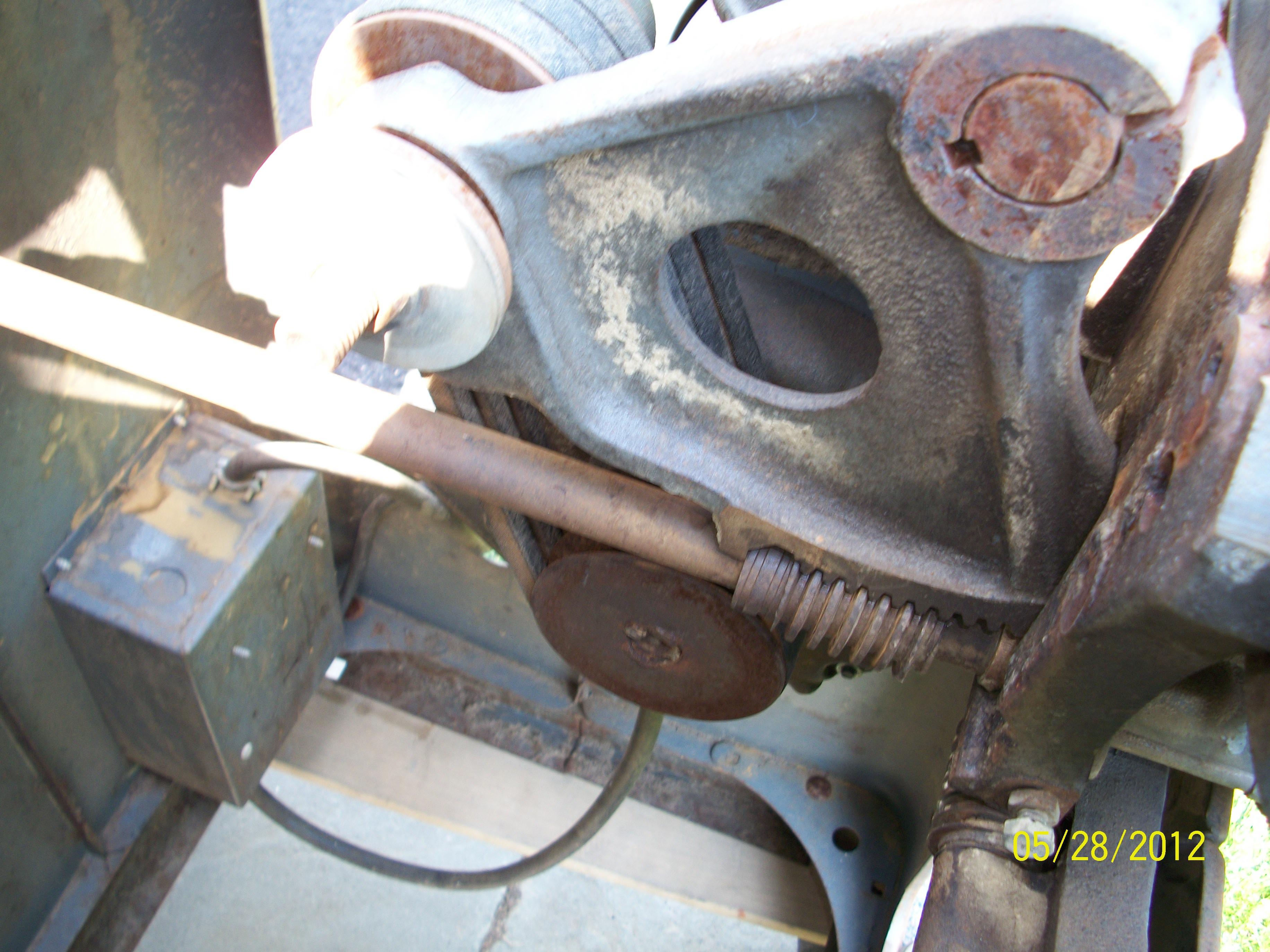

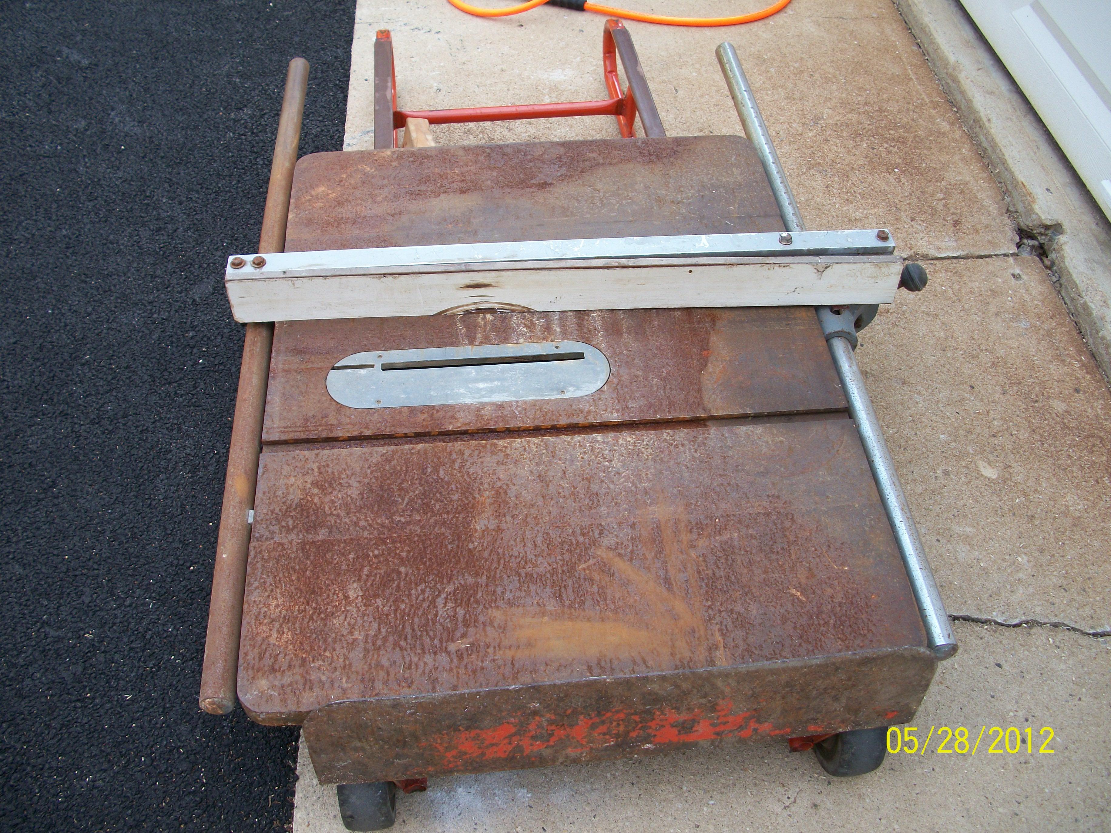

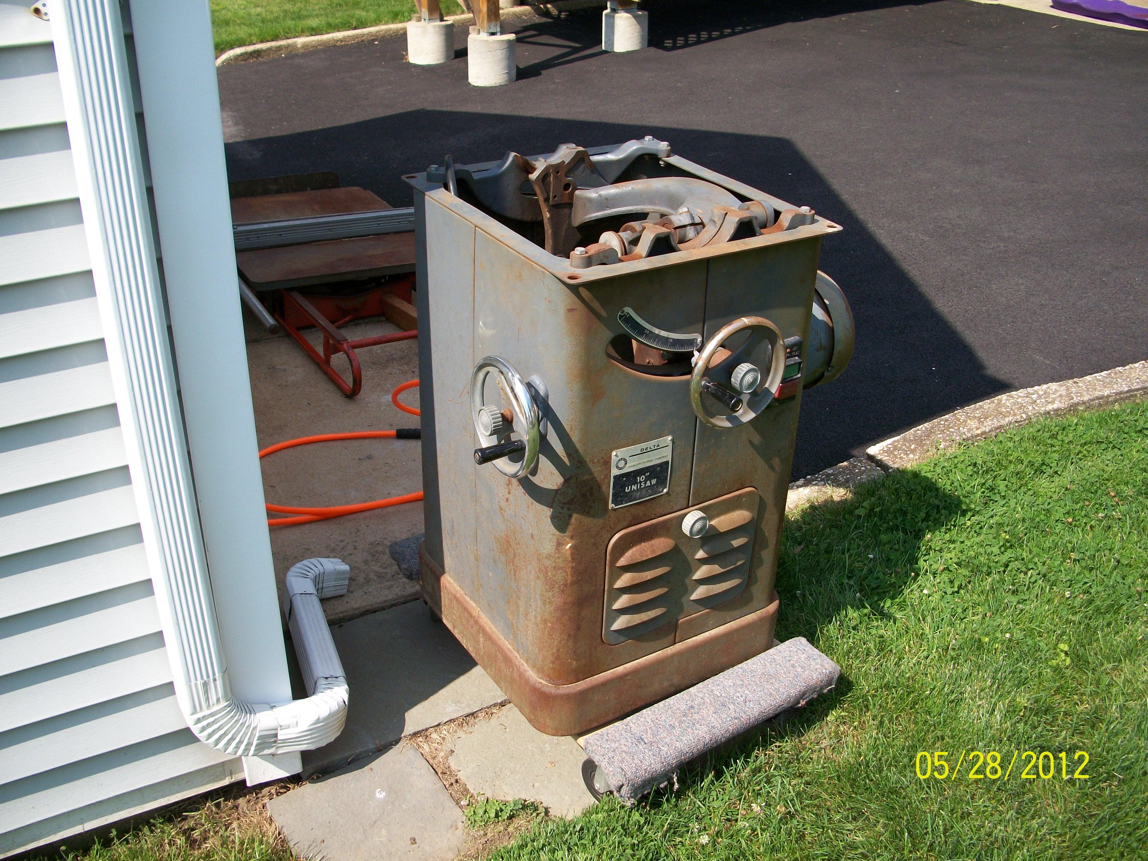

                took a drive this morning and picked up the RAS and the unisaw. turns out the motor is a dual voltage 3 hp 220v 1ph baldor. spoke to my electician regarding the possible rain exposure and he advised leaving it in my shop till next weekend, then try to fire it up. any water or dampness should have dried/evaporated by then.
                apart from an above average amount of rust on the table, rails and lower half of the saw cabinet, the saw is pretty clean. motor and arbor both spin with no grinding noises and the arbor bearing feels solid. i threw a digital gauge on it and got a max reading of 0.002" as i rotated the arbor flange. sprayed some liquid wrench in the raise/lower and bevel gears and ways and things are starting to loosen up.
                first surprise was that the arbor nut is a left hand thread. the fence is going to need a considerable amount of work to get it to move freely. as i'm not yet sure if i'm keeping the saw, i don't want to start pumpimg money into it, especially not until i'm sure the motor runs. this will be my first real resoration porject and i'm looking forward to working on it as time allows. hopefully, once once it starts (fingers crossed), it wil perform so wonderfully i won't want to part with it. now if only it were a left tilt......

                    i’ve see the steve shanesy (?) set of youtubes on unisaw restoration. anyone found anything better and more specific, like not skipping motor belt removal when discussing changing the arbor bearing?

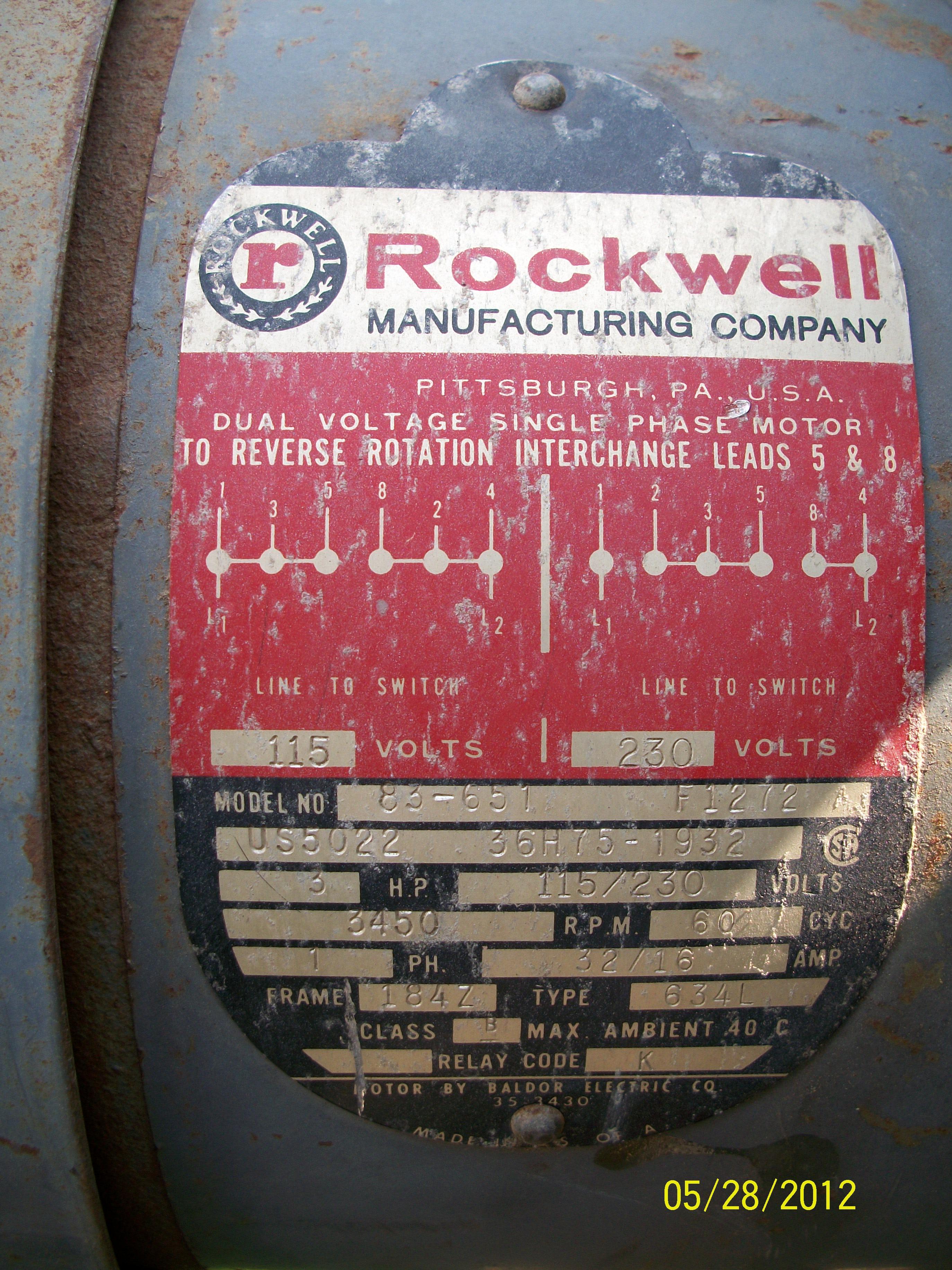

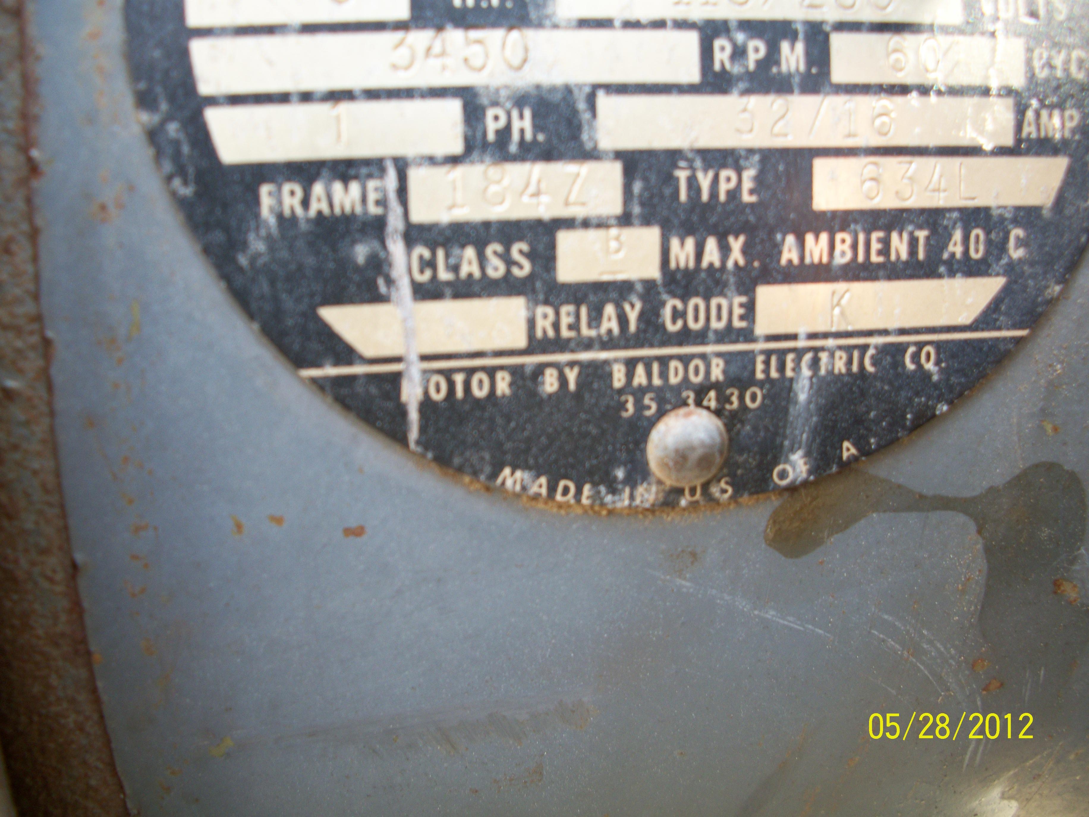

                        i got an email reply yesterday morning from the tech(ies) @ the sawcenter to the video links i sent them of the recently acquired uisaw. they thought 1) there was pulley runout on the motor that needed to be investigated and 2) the arbor bearings needed replacing. so i pulled the motor and got it to the local baldor authorized repair shop to see what they say. since any motor maladies are likely to be the most significant problem this saw will face, it's future may depend on what they find.
                        well, the dreaded call came a liitle while ago informing me that the motor shaft is bent and they tell me it would cost less to get a new motor than to rebuild the original. anyone got any ideas about what to do at this point ? i've looked on ebay and all the "unisaw motors" that pop up have a different frame designation than what is printed on the data plate of my unisaw motor. i know the arbor bearings need to be replaced, but that's not a major expense, and the top will clean up well and i got the original fence to work like new. kinda be a shame to remove this unit from service. remember, i'm only into it for $40 right now so parting out the saw is also a potentially profitable option. constructive suggestions welcomed.

                            looks like this would be one of the more reasonable replacement units (shipped spprox. $400):
                            http://www.ebay.com/itm/3-HP-Leeson-...item519fc1159a
                            a replacement from delta is $665 and the comparable 3hp sawcenter motor is $579. none of the new motors are dual voltage and reversible like the OEM motor on the saw. pity someone abused it previously.
                            another alternative suggested was to have a machine shop straighten the motor shaft once the motor was disassembled for bearing replacement. but, as the seller of the 3hp leeson motor noted, even if that works, you still have a 40 y/o motor with 40 y/o windings. anyone ever do something like that and care to comment on the outcome of such an undertaking?

                              Have you checked Grainger? They have a lot of motors with less common mounting arrangements.
                              Another option may be to buy or make an adapter for it, so that a standard motor could be used. I recall some prior discussion about that on one of the boards, but haven't tried it myself.

                                thanks for the suggestions. grainger does have the same 3hp leeson as i linked, but it's $145 more at grainger than the other retailer's website price. and, unfortunately for the purist in me, i've dismissed the idea of an "adapted" replacement motor. something about it just says "this isn't right". anyone out there had a motor's shaft straightened and what was the outcome of the effort?
