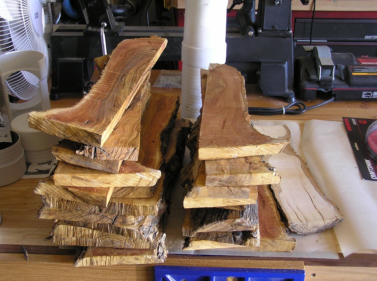

          I bought my riser block at Rockler - now priced at $99. Grabbed a 5/8 Olson because I couldnt wait for Lenox, and with my Rockler 20% off coupon from the recent mailer, was out the door for $110.
          Here's the mod'd saw, and the slabs of Olive my neighbor asked me to produce from the trunk segments he had (not sure which I'll get to keep, but around 1/2, all with some nice figure.)
          Ran great until the wet wood started to gum up the side of the blade - so I stopped, cleaned the blade, and waxed - worked great again.
          Thanks for looking.
            fun, did you build or buy a sled to help cut logs? I always though you needed one to help keep the rolly side of the log stable enough to make parallel cuts.
              Loring, I used the same sled I made a while back, shown here: http://www.bt3central.com/showthread...ight=log+resaw
              But the limited width meant I needed to saw the log in half first, then continue slabbing off the remaining half, remount the other half, and slice it up too.
              So I may need to make a wider sled to slab through an entire 12" segment without the hokey pokey described above.
              On the second log, I cut in half, then quartered, and proceeded to QS via my fence through the quarters. Worked ok this way, but smaller slabs.
