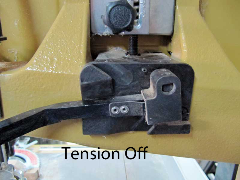

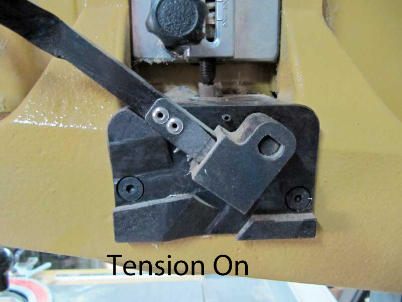

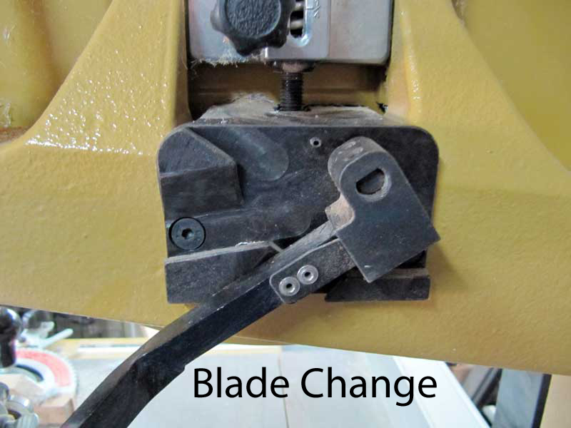

              I have the Carter system on my PM and it is designed with a stop to just release tension and then can be dropped all the way down for a blade change.

                Dick, - 3 way - Tension, Tension Release, Blade Change. But of course - your BS is Gold and has Cartier fittings! That is nice!
