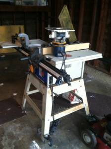

    Is this a bt3100?
    A buddy is renovating a house he just got and he asked to keep an eye out for a good TS. He doesn't want to spend alot, wants it semi portable (or at least moveable), and basically wants it for home improvement. But may want to do some fine woodworking in the future. Of course one of the saws I suggested is the bt3. Found this on on CL and was wondering if it is a 3100?
    Yep, that's what it is!
    • jussi
      • 2162
      Been a while since I had a bt3. Is adjusting the top so that the miter slots are parallel to blade pretty easy? What should I tell him to look for when inspecting the saw?
        There are no miter slots. The saw utilizes a SMT in place of miter slots. Some people find it tricky to align the SMT, others say they have no problems. If you recall there is the SMT base and three of four screws on the table are eccentric allowing alignment.
