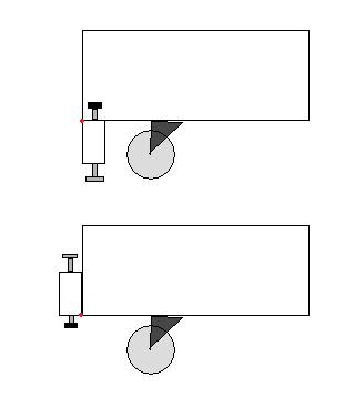

          Here's a crude illustration of what I have in mind. They'd be flipped down and then lower the leveler feet with a handle. When you don't need them, raise the leveler a little bit and flip them out of the way. The casters would still carry some of the load. The leveler feet are to keep it from moving around.
          Thanks!

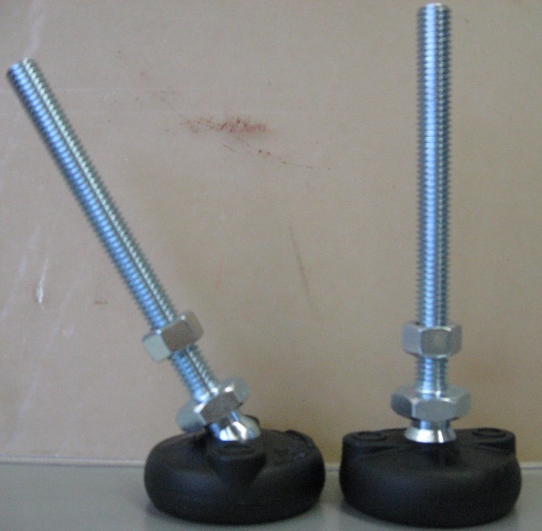

                    I have these sitting at my desk
                    AndyF:
                    Don't know how many you want, but I have these sitting at my desk, it's yours if you want them. No strings, no gimmicks, just a fellow BT3 member helping out another.

                      Originally posted by Monyet
                      AndyF:
                      Those would work nicely. I'm looking for 4, but I'd be happy with two.
                      Check your Private Messages.
