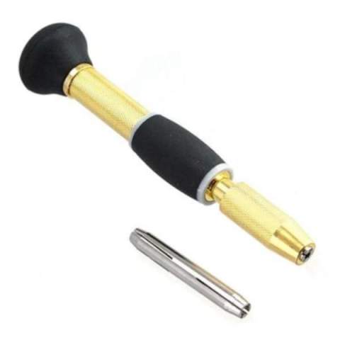

            How small is tiny? If you're talking about #60-80 type bits, a pin vise would suffice.
            • RodKirby
              • 3136
              • Mao Shan TSC-10RAS
              Ditto - I use one for my plastic model aircraft.
