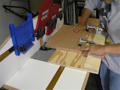

                    If your router table has a miter slot on it, skip the bearing/fence alignment, and use a sled. If you're careful to attach a dead-straight miter bar, you can make one as long and wide as you can safely handle on your table. I used one like this for small panel jointing before buying my benchtop jointer (as demonstrated by LOML):

                        I ended up making a mini sled and I think it turned out well. We'll see come assembly time.
