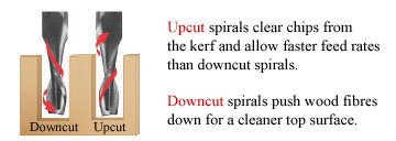

                      Does this help?
                      Ray

                          Regardiong left handed bits - I just can't see any reason for one to exist. Now there are upcut and downcut spirals and at first look they look right and left handed:
                          However, on close inspection its seen the cutting edge is in the clockwise direction (with the bit pointing down of course, all referenced router directions are usually for handheld orientation rather than table-mounted)
                          and the spiral direction is up or down rather than right or left.
                          I wonder if someone thought a upcut bit was a left-handed router bit?
