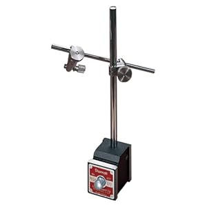

    It looks very similar to a "magnetic base" used by machinists on lathes and mills as well as setting up other machinery.

          It's a scriber. It's used to scribe a line on a workpiece.
          For example, if you have a cube of metal and need a "level line" around it, the metal cube is placed on a surface plate, the scriber is adjusted to the level of the line, and the scriber is moved around the work piece, scribing the line. It scribes a line a fixed distance from the surface plate.
          In woodworking, we use a marking guage to do essentially the same thing.
          In these links, they call it a "surface guage", so maybe that is the proper term - but we always called them "scribers".

            Ah, that's it! The second link has a drawing that matches almost perfectly!
            Thanks a bundle!

                  Its a surface gage.
