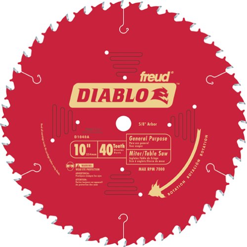

    Does anyone know what the difference is between Freud's Diablo line and their Industrial line of blades? I see some that look nearly identical from each line, right down to the drilled holes through the plate which I can only assume are to balance the plate or from machining processes.

      It's been a few years since that thread. Freud's website is a lot better than it used to be. In a nutshell, there's definitely some similarities between the Diablo and Industrial line. The Diablo line is strictly thin kerf choices, and is much more limited than the Industrial. The industrial blades usually have more carbide for more sharpenings. Blades like the LU86R010 and the Diablo D1040 have similar geometry, but the carbide on the LU86 is larger.
      Be aware that Freud has discontinued the Avanti line as of June 2009. It's now being sold at HD, has been severely compromised as cheap Chinese made knockoffs...to be avoided for sure. Some NOS may still be around, but check for the Freud name to be certain.

          Excellent as always gentleman, thank you. I don't know what resharpen would run with shipping and all, so for me I do believe the better alternative would be the diablo, at 1/2 the price of the industrial line and just buy a new blade when needed.

            here i think the local guys quote $0.30 or 0.33 a tooth, maybe that'll give you an estimate.
              Thanks Loring. What has been your experience with resharpening blades? Have they come back as good as new? Do they check to make sure the plate is still in good condition? I noticed that on the blades they mention a c-4 grade of carbide, is that something that is serviceable at most facilities that resharpen? What about tooth geometry?

                I'm pretty sure the good sharpeners have an indexing table to sharpen each tooth advancing at the angle between teeth (i.e. 9 degrees advance between reach tooth on a 40T blade; thats 360/40). Reproducing the original hook angle and top bevel then depends on how correctly they place the abrasive w/ relation to the blade/table. I'm sure they have diamond abrasives that can handle any of the standard C2, C3, or C4 carbides used for WW.
                well funny you should ask, I've had a couple of blades sharpened. When i did so I replaced it with a new one and so far I have not yet put the sharpened blades back on. So I can't really answer that one well.
                But I expect they should be good. You might try Forrest's resharpening service. If one of the secrets to their blades is great sharpening, then sharpening another quality brand saw blade should give excellent performance.

                  According to Forrest's web site a 36 tooth blade would cost $20.50 to resharpen and $9 s/h plus whatever it would cost for you to mail it to them, making it a simple choice in this case for me to buy new.
